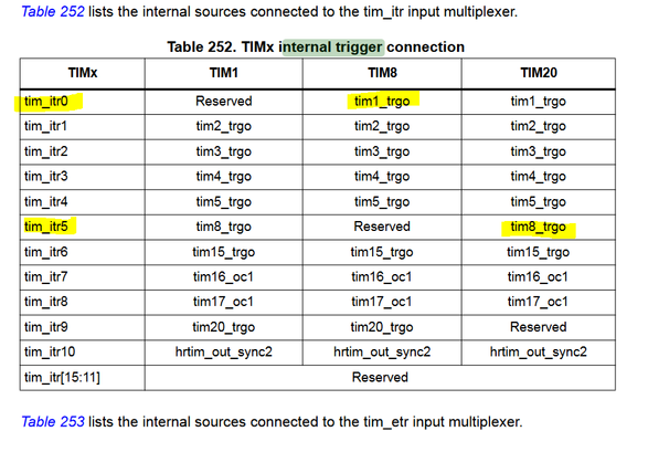

Ok, so as stated in the reference manual, there are TIMx internal trigger connections, which I thought can be used for chaining 3 timers: TIM1, TIM8, TIM20 because they can generate complementary outputs as well:
According to Table 252, I should have easily set this up with MX. I started to process this table, TIM1 is the first timer which can trigger TIM8 through ITR0, and TIM8 can trigger TIM20 through ITR5.

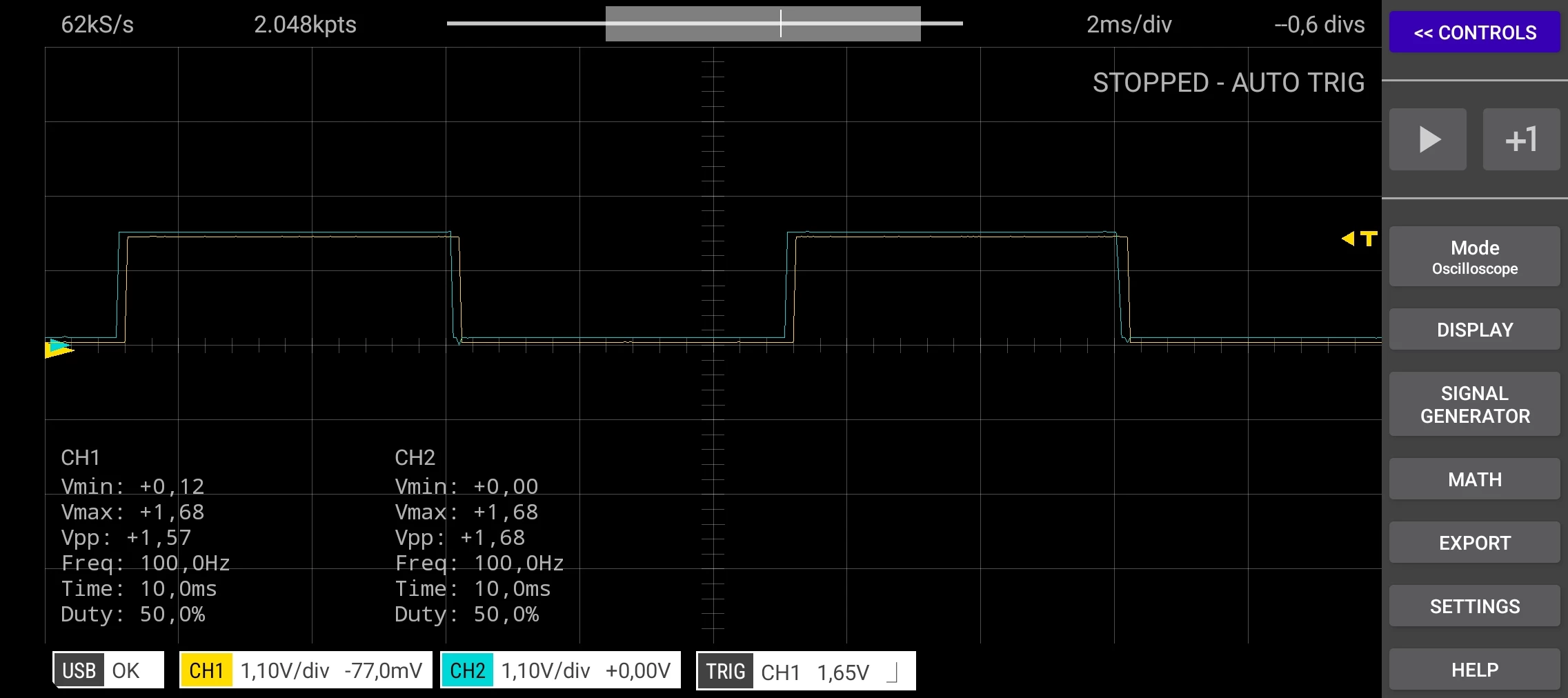

The outcome is that TIM1 and TIM8 are basically the same, with just a few microseconds delay between each other:

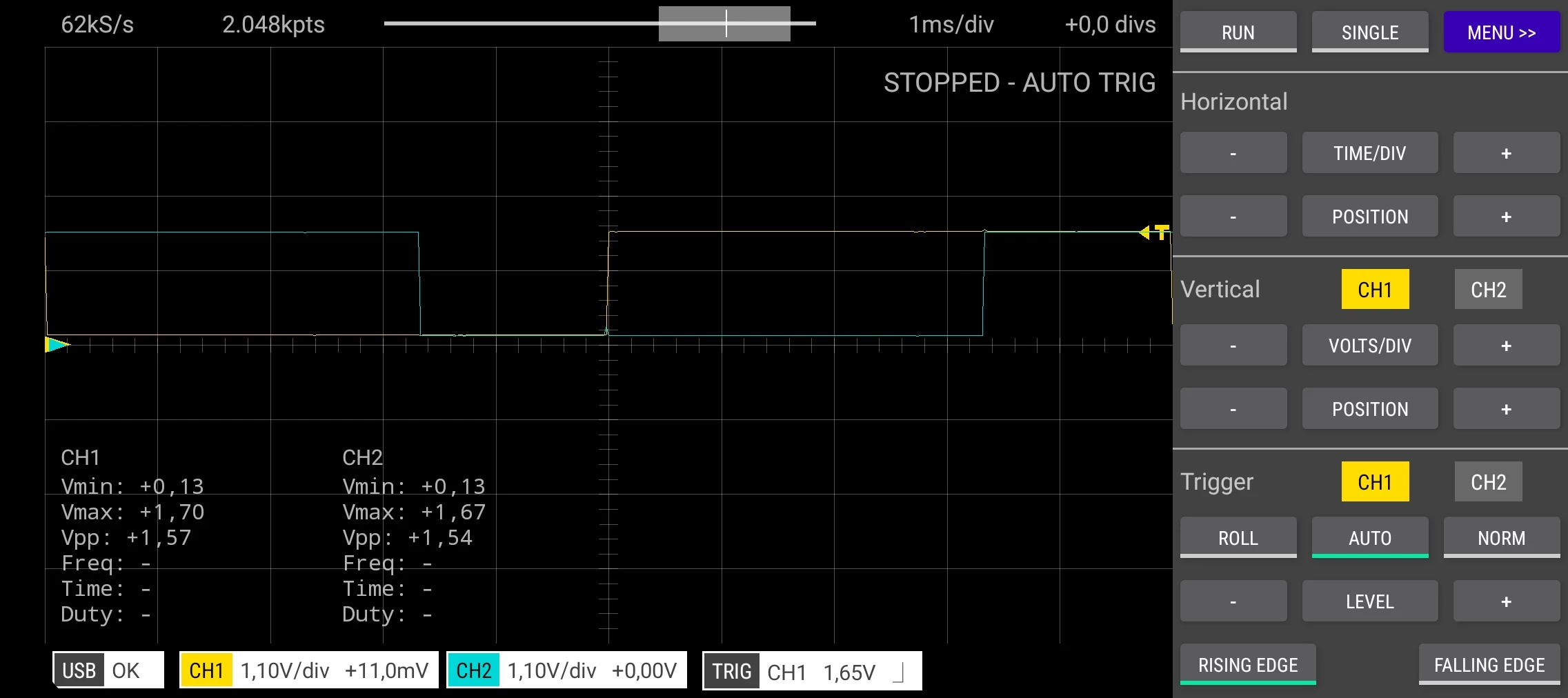

TIM20 is 120 degree phase shifted from TIM8:

The original question's problem usually lies in incorrectly started slave timers. The point of slave-mode controller in Trigger mode is, that when trigger arrives, the TIMx_CR1.CEN bit is set, that's all. In other words, you are not supposed to set that bit "manually", and you are also not supposed to enable the master timer (set its TIMx_CR.CEN) before all slave timers are set up. A good way to check if this all is fulfilled is to set up everything except setting master timer's TIMx_CR.CEN, and at that point read out and check all timer's registers if they are set as expected.
