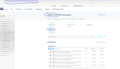

more generally you can find the errata sheet for every series on st web site :
https://www.st.com/en/microcontrollers-microprocessors/stm32f1-series/documentation.html
