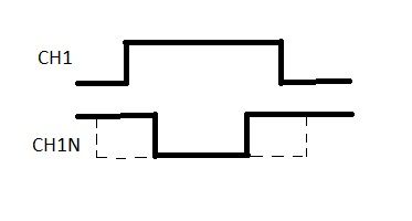

mehmet.karakaya
Posted on October 17, 2012 at 22:08
hello thank for the answer
I changed the initializing code according to your example
and I call folowing functions to start PWM
TIM_SelectOCxM(TIM1, TIM_Channel_1, TIM_OCMode_PWM2);
TIM_CCxCmd(TIM1, TIM_Channel_1, TIM_CCx_Enable);
TIM_CCxNCmd(TIM1, TIM_Channel_1, TIM_CCxN_Enable);
yes I got complementary signals at CH1 and CH1N
however dead time generator insert dead time at wrong places
I draw  the osciloscope image above
as you can see ON times of mosfets collide ( the dark lines )
I want dead times like as shown in the dashed lines
what I must change in the code ?

Because you have OCxN active low the dead time won't work.  During the deadtime gap both signals are driven to the inactive level....low for OCx and high for OCxN, so the H-Bridge stays on.  OCx and OCxN polarity should match when driving a bridge, unless you have an inverter on one side.
TIM_OCInitStructure.TIM_OCPolarity = TIM_OCPolarity_High;
TIM_OCInitStructure.TIM_OCNPolarity = TIM_OCNPolarity_Low;
should be:
TIM_OCInitStructure.TIM_OCNPolarity = TIM_OCNPolarity_High;
Jack Peacock
