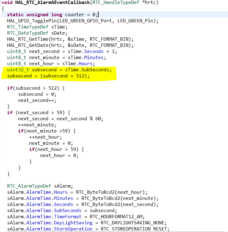

Thank you for your response. I've scenario where I need to set an interrupt which is user configurable and time varies from hours to milli second. I am really not sure whether wakeup counter can serve this purpose. For an example, user can configure interrupt at every 9 hours, 9 minutes, 9 second and 9 millisecond.
I also understand Periodic Alarm logic and to handle the requirement I've, I incremented alarm periodically based on second, minutes and hour value. Using the below code, I achieved generating periodic interrupt using alarm but somehow millisecond part is not working as expected. If you could help me to resolve this issue, it would be of great help.
HBavi.1
I've attached image for your reference. Somehow millisecond handling is not working as expected. It would be great if you could suggest better way to handle millisecond interrupt.

Subseconds (RTC_SSR) are often misunderstood because they don't count up but count down:
"The ck_apre clock is used to clock the binary RTC_SSR subseconds downcounter. When it reaches 0, RTC_SSR is reloaded with the content of PREDIV_S."
With a clock of 32768Hz, PREDIV_S (the 15bit synchronous predivider) is normally set to 256-1. Due to the downcounter you have to think the other way around in order to program a time difference for a future interrupt, i.e. subtracting it from the current value and correct the underflow, like e.g.:
// for 32kHz, PREDIVS=255 --> e.g. 80/256*1s=312.5ms
uint32_t subseconds_diff = 80; // example
// threatens underflow?
if (subsecond < subseconds_diff)
  // yes, add PREDIV_S+1 first:
  subsecond = subsecond+hrtc->Init.SynchPrediv+1-subseconds_diff;
  next_second++;
else
  subsecond -= subseconds_diff;
Please insert the following lines to get the next alarm:
// mask date and weekday as only hh:mm:ss:sss is of interest:
sAlarm.AlarmMask = RTC_ALARMMASK_DATEWEEKDAY;
// use subseconds:
sAlarm.AlarmSubSecondMask = RTC_ALARMSUBSECONDMASK_NONE;
// alarm is not triggered if missing:
sAlarm.AlarmDateWeekDaySel = RTC_ALARMDATEWEEKDAYSEL_DATE;
sAlarm.Alarm = RTC_ALARM_A;
BTW: please use the Code Snippet button </> to insert source code.
When your question is answered, please close this topic by choosing Select as Best.
/Peter
