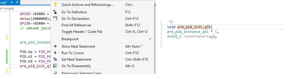

Posted on January 03, 2018 at 13:43
I think I am. When I click Go to Definition it opens arm_math.h and shows me this.
Posted on January 03, 2018 at 13:58
Ha - that's Keil being sloppy with their terminology!
That is just a function prototype - it is not a definition - it is just a declaration.
See: C-FAQ
http://c-faq.com/decl/decldef.html
So, as in the previously-linked forum thread, you need to also include the .c source file which provides the actual definition (ie, the implementation) of that function ...

Posted on January 03, 2018 at 14:09
Ok, thank you!
I searched for .c file and found that there is \STM32H7xxxx\CMSIS_HAL\DSP\Source\ControllerFunction\
arm_pid_init_q31.c
So I included it in my code and now I can build it.
