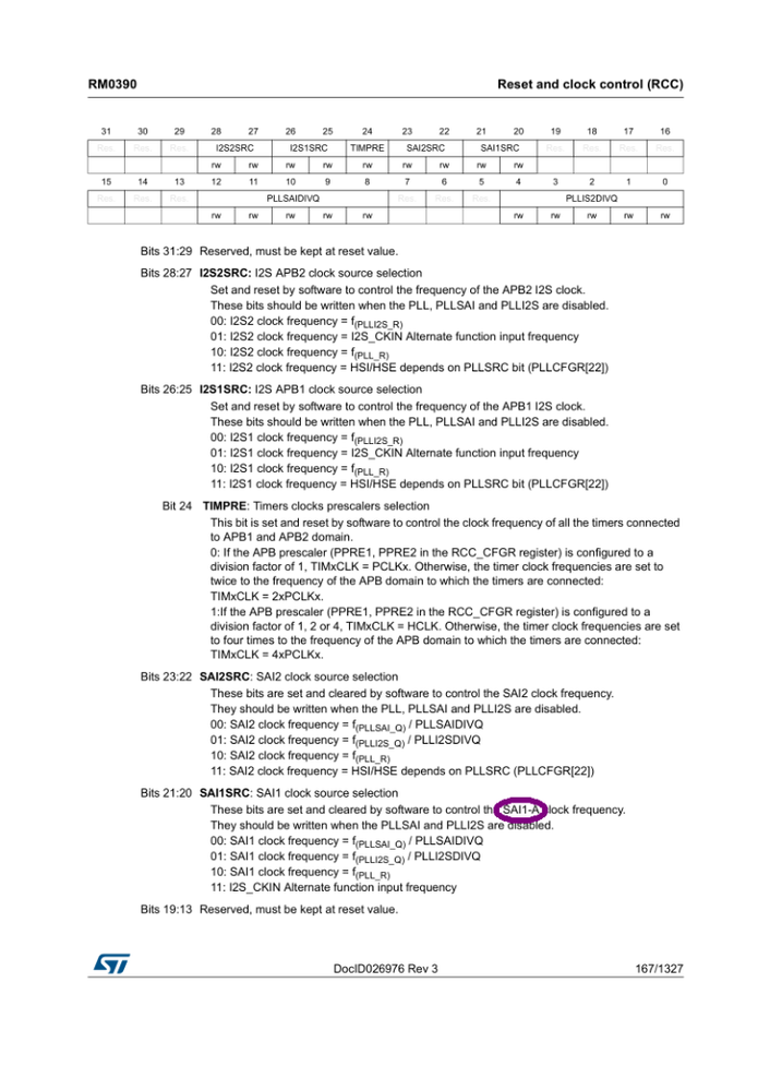

['F446 documentation] RCC_DCKCFGR.SAI1SRC - is it only for SAI1-A?
waclawek.jan
Posted on January 02, 2018 at 22:54
Is this a typo, or are there some other register bits which allow to select the source of the SAI1-B clock frequency?
1 REPLY 1
Imen.D
Posted on January 03, 2018 at 15:26
Hello
Waclawek.Jan
I confirm this typo, it should be SAI1.
I raised this typo internally to correct it in the next release of reference manual.
Thank you for highlighting the issue and sorry for any inconvenience it may bring.
Best Regards
Imen
