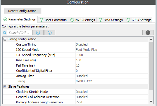

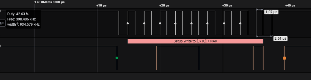

0693W00000NqrMkQAJ.pngI'm trying to configure the I2C to run at 1Mhz(Fm+) on STM32L496. As per the RM0351, it does support fast mode plus mode. I tried generating the code from STM32Cube IDE and check the SCL pin of logic analyzer. However, I see 400 khz I2C clock frequency. How do I achieve 1Mhz I2C clock?
Configurations:
I2C peripheral: I2C2
I2C clock source: SYSCLK
SYSCLK freq: 80Mhz
Code generated:
/** I2C Initialization
 LL_I2C_EnableAutoEndMode(I2C2);
 LL_I2C_DisableOwnAddress2(I2C2);
 LL_I2C_DisableGeneralCall(I2C2);
 LL_I2C_EnableClockStretching(I2C2);
 I2C_InitStruct.PeripheralMode = LL_I2C_MODE_I2C;
 I2C_InitStruct.Timing = 0x00B0122F;
 //I2C_InitStruct.Timing = 8459040;
 I2C_InitStruct.AnalogFilter = LL_I2C_ANALOGFILTER_DISABLE;
 I2C_InitStruct.DigitalFilter = 0;
 I2C_InitStruct.OwnAddress1 = 0;
 I2C_InitStruct.TypeAcknowledge = LL_I2C_ACK;
 I2C_InitStruct.OwnAddrSize = LL_I2C_OWNADDRESS1_7BIT;
 LL_I2C_Init(I2C2, &I2C_InitStruct);
 LL_I2C_SetOwnAddress2(I2C2, 0, LL_I2C_OWNADDRESS2_NOMASK);
 /** I2C Fast mode Plus enable
 LL_SYSCFG_EnableFastModePlus(LL_SYSCFG_I2C_FASTMODEPLUS_I2C2);
However, I see only 400khz on logic analyzer. Can someone help where I might be getting it wrong?
I'd also like to understand how the timing register value is calculated. I didn't get much from RM. They say use STM32Cube IDE for accurate values.
Thanks,
Abhijit Nathwani

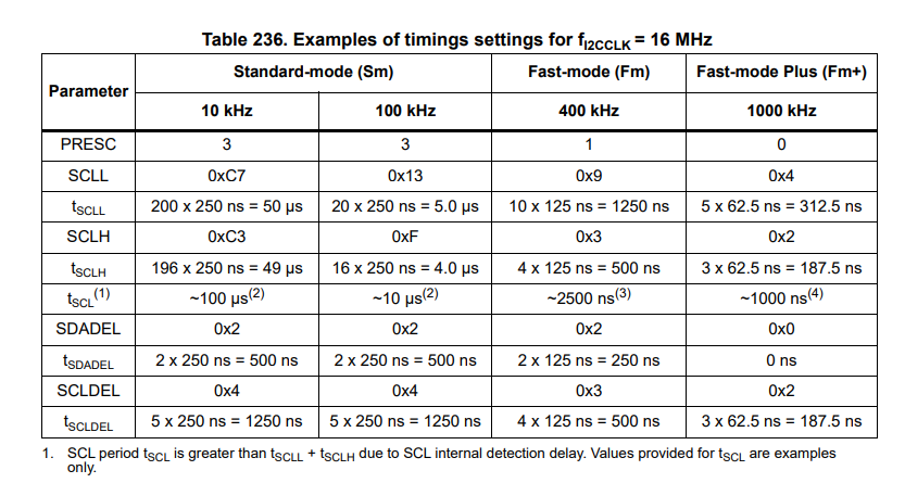

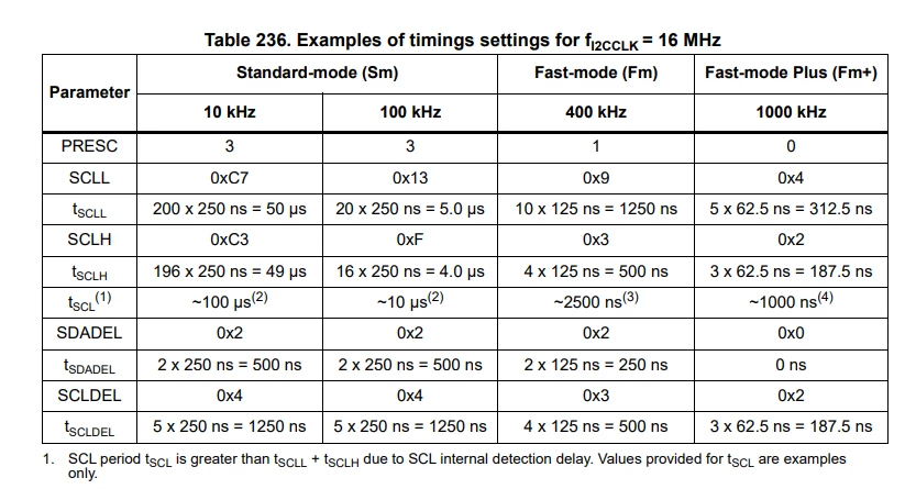

the system clock may be 80MHz, but what clock is configured for the I2C peripheral?
In the RM0351 there is an example configuration of working 1MHz timing settings with 16MHz peripheral clock.

As I mentioned in the post, the I2C clock source is SYSCLK(80 Mhz).
As per your recommendation, I tried to replicate the settings shared in RM0351 for Fm+ mode. However, I still see the same behavior.

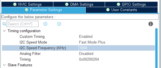

0693W00000NqzSRQAZ.pngI2C clock source set to HSI clock running at 16Mhz.
Based on the values in the table above:
PRESC = 0x0
SCLL = 0x4
SCLH = 0x2
SDADEL = 0x0
SCLDEL = 0x2
This values the timing register value as 0x00200204
I set this as custom timing in the CubeIDE however the behaviour is still the same.
