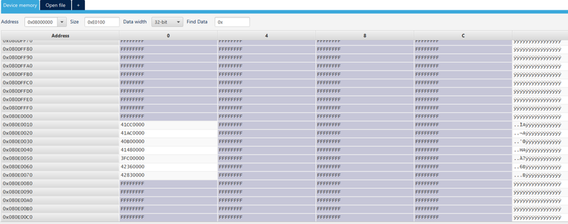

Everything seems to be fine according to the logs:
Program started
FLASH_WRITE_OK
read_value1 float = 25.50
FLASH_WRITE_OK
read_value2 float = 21.50
FLASH_WRITE_OK
read_value3 float = 5.50
FLASH_WRITE_OK
read_value4 float = 12.50
FLASH_WRITE_OK
read_value5 float = 1.50
FLASH_WRITE_OK
read_value6 float = 45.50
FLASH_WRITE_OK
read_value7 float = 65.50

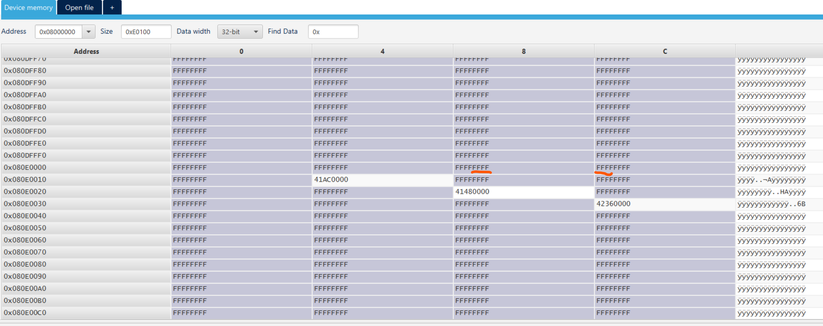

However, when I try to change the addresses to which I am writing (not alligned to 4 bytes):
  FLASH_erase_all();
  // Write and read multiple floats using 4-byte aligned addresses
  float value1 = 25.5;
  uint32_t value1_address = SECTOR_11_START + 10;
  FLASH_write_single_float(value1_address, value1);
  float read_value1 = FLASH_read_single_float(value1_address);
  printf("read_value1 float = %.2f \n", read_value1);
  float value2 = 21.5;
  uint32_t value2_address = SECTOR_11_START + 20;
  FLASH_write_single_float(value2_address, value2);
  float read_value2 = FLASH_read_single_float(value2_address);
  printf("read_value2 float = %.2f \n", read_value2);
  float value3 = 5.5;
  uint32_t value3_address = SECTOR_11_START + 30;
  FLASH_write_single_float(value3_address, value3);
  float read_value3 = FLASH_read_single_float(value3_address);
  printf("read_value3 float = %.2f \n", read_value3);
  float value4 = 12.5;
  uint32_t value4_address = SECTOR_11_START + 40;
  FLASH_write_single_float(value4_address, value4);
  float read_value4 = FLASH_read_single_float(value4_address);
  printf("read_value4 float = %.2f \n", read_value4);
  float value5 = 1.5;
  uint32_t value5_address = SECTOR_11_START + 50;
  FLASH_write_single_float(value5_address, value5);
  float read_value5 = FLASH_read_single_float(value5_address);
  printf("read_value5 float = %.2f \n", read_value5);
  float value6 = 45.5;
  uint32_t value6_address = SECTOR_11_START + 60;
  FLASH_write_single_float(value6_address, value6);
  float read_value6 = FLASH_read_single_float(value6_address);
  printf("read_value6 float = %.2f \n", read_value6);
  float value7 = 65.5;
  uint32_t value7_address = SECTOR_11_START + 70;
  FLASH_write_single_float(value7_address, value7);
  float read_value7 = FLASH_read_single_float(value7_address);
  printf("read_value7 float = %.2f \n", read_value7);
it no longer able to read the values properly :
Program started
ad_value1 float =FLASH_WRITE_FAIL
read_value1 float = -nan
FLASH_WRITE_OK
FLASH_WRITE_FAIL
read_value3 float = -nan
FLASH_WRITE_OK
FLASH_WRITE_FAIL
read_value5 float = -nan
FLASH_WRITE_OK
FLASH_WRITE_FAIL
read_value7 float = -nan

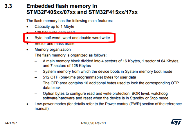

The RM does say that byte, half-word (16 bits?) word (32 bits?) and double-word (64 bits?) should all be possible:

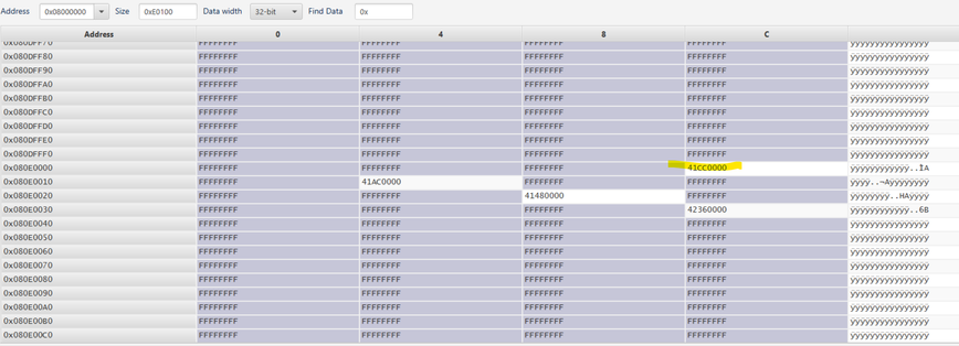

@Andrew Neil Yes you can still write as a word or any of the other writes, but it still has to align to within a column. Right now the OP is trying to write part of his float in column 8 and C when he use decimal 10, 20, 30, etc. In this case for decimal 10, it fails to write anything and still shows 0xFFFFFFFF
Here is when writing at SECTOR_11_START + 12 which is now aligned in a column and not overlapping into another column. So in this case it does write the value in flash correctly.
I originally thought the OP was trying to increment the address so it would align like this. So I told him to use hex 0x10, 0x20 and so on

The size of the write determines the permitted granularity, word and half-word can't SPAN
Other STM32 have MORE restrictions, depends on the flash-line widths, which frequently contain more bits, hidden, which contain ECC or HAMMING type data.
