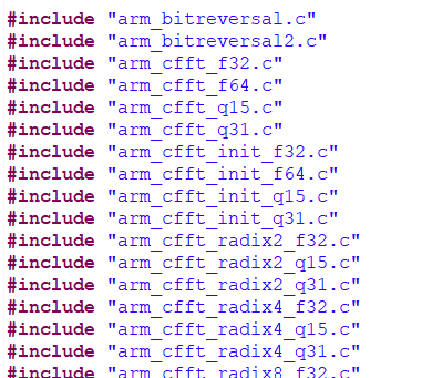

‎2024-05-15 8:54 AM
Thank you for breaking down the problem.
I found that in Transform.c all the .c are included
Since DSP is a standard library I believe I should not be modifying it.
Please suggest me how can I resolve this error?
‎2024-05-15 9:00 AM
@NNada.1 wrote:Please suggest me how can I resolve this error?
Again, you need to choose either one or the other - you can't have both in your Project!
