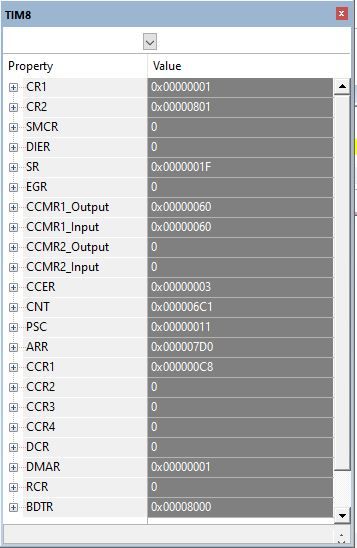

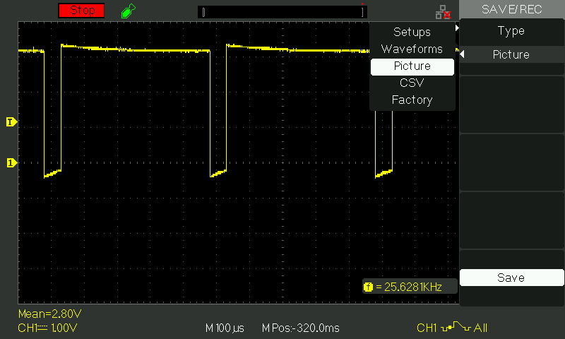

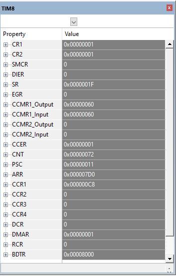

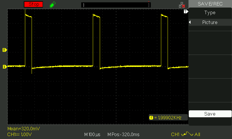

‎2020-05-09 11:28 PM
Which pin? Isn't it TIM8_CH1N?
Read out content of the TIM registers before the change and after and compare/post together with respective waveforms.
‎2020-05-10 1:01 AM
PC.6 TIM8_CH1 default pin
‎2020-05-10 1:17 AM
‎2020-05-10 3:33 AM
CC1P in CCER has changed that is normal but OIS2 in CR2 has changed too.
‎2020-05-10 5:20 AM
OK so now if you perform the same change by directly writing to registers, you will see the waveform changing in the same way too.
To try it, you don't need to write any code, simply change it directly in the debugger.
