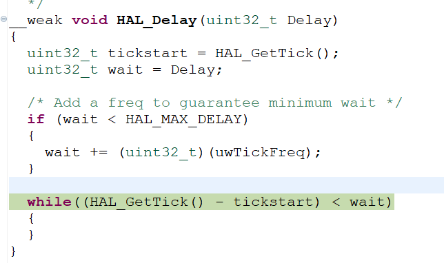

> the delay function in the application code is not working
The code presented looks okay to me. Maybe the delay function is bad?
Debugging the code and stepping through should show the issue.

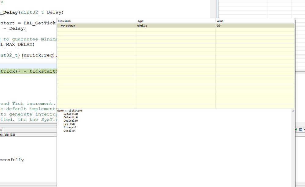

2025-12-03 6:38 AM
It cannot return from this while loop. I am thiking that because of vector table at the begining of flash memory. Because when I loaded the code to the begining of flash, it workes as should be. Delay funtion can't get the tick value.

It doesn't working.
