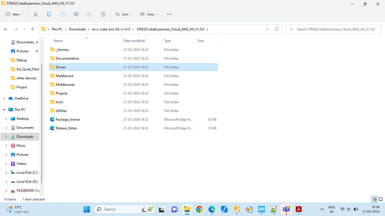

After downloading the X-CUBE-AWS H5 extension, I am seeing the below files. How do I find library file to add it cube IDE?

@Nagarajan
All available projects are under the folder project of your X-CUBE-AWS H5. You can follow the procedure of integration on one of them to understand how to add this package to your project

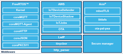

I added aws_eth project in STM cube IDE and able to build the project. It seems like all the below supporting packages are required to run this project. How can i see the output of this project?

grd
Hi @Nagarajan ,
the best match for starting an application connecting to AWS IoT Core on STM32H563-ZI Nucleo is the X-CUBE-AWS-H5 expansion package.
Note however that:
1) only the non-TrustZone application variants can be reused, since the TrustZone applications depend on the ST Secure Manager (X-CUBE-SEC-M-H5 expansion package), which is specific to STM32H573.
2) the Nucleo board misses the external flash component of the STM32H573I-DK discovery kit. So you will have to replace the permanent storage backend of the example application (littlefs / external flash) by your own solution. Please also note that this application variant implements the OTA firmware update feature by swapping the banks of the internal flash. So the internal flash may not be the easiest choice as permanent storage backend.
