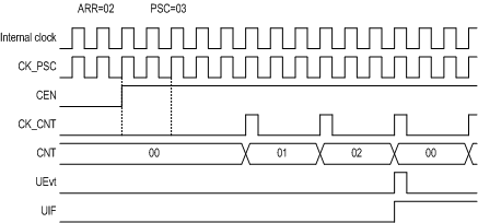

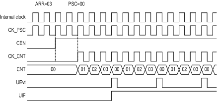

Thank you for your reply. I have prepared a drawing that takes into account your answer. Please correct me if something is wrong.
I steel do not know what is the relation between the CEN bit and the CNT_EN signal. Is it set 1 clock cycle after CEN bit?
I also don't know how the counter starts when the PSC is different from 0. For this case I have also prepared a drawing. If it is incorrect, I would be grateful if you could point out any errors in it.
Best regards,
Mirek
‎2019-09-10 8:02 AM
​Hello Mirek,
The 2 drawings are perfect.
The CNT_EN (counter enable) signal is set 2 cycles after CEN bit write. But you better not mention this, it doesn't bring much to the understanding of the timer, and it is even confusing. It is enough to see the ck_cnt starting 2 cycles after CEN.

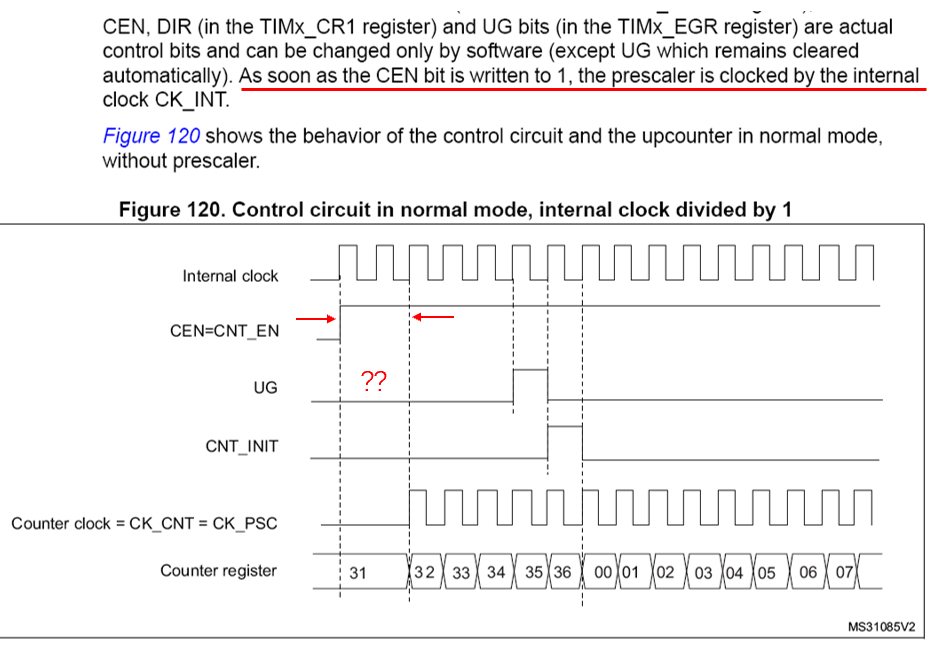

‎2020-03-20 7:56 PM
Hi, Vincent,
I just posted a post asking for the same question. Then got member told me this was discussed last year. So I searched in the forum and came to this post.
Just to clarify, in that case, for the statement "Note that the actual counter enable signal CNT_EN is set 1 clock cycle after CEN" it is still valid, is it?
From CEN to CNT_EN there is 1 clock cycle, then due to prescalor is 0, the CK_CNT is the same frequency as the CK_INT. But for CK_CNT, the clock appears 1 prescaled cycle after the CNT_EN. That explains the 2 clock cycles here in the Figure 120 (The figure is from RM0008 Reference Manual). Is that right?
Also, another stupid question, CEN, DIR and UG are bits in different registers. Then what about CK_INIT, CNT_EN, what are these signals?

This is my understanding version of this problem. It says "Note that the actual counter enable signal CNT_EN is set 1 clock cycle after CEN"
So CNT_EN should be 1 clock cycle after CEN bit. Meanwhile, it seems that from CNT_EN, the count will start counting from the original value in the counter register, so the CK_CNT will start 1 prescaled cycle from the CNT_EN trigger.
Therefore, when PSC=00, it shows as 2 clock cycles from CEN to CK_CNT.
When PSC=03 as you set in your 2nd figure, I think that is wrong. The frequency is divided by (PSC+1). So if PSC=03, then the CK_CNT frequency should be divided by 4 (your one is divided by 3). I suppose that is wrong. And based on my aforementioned understanding, from CEN to CNT_EN 1 clock cycle, then to CK_CNT first rising edge should be 1+(PSC+1)=5 clock cycles, which is correct in your case.
