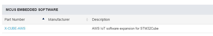

Have a look to the
http://www.st.com/content/st_com/en/products/embedded-software/mcus-embedded-software/stm32-embedded-software/stm32cube-expansion-software/x-cube-aws.html
software expansion package which contains libraries and example projects.0690X000006078MQAQ.png
Imen
