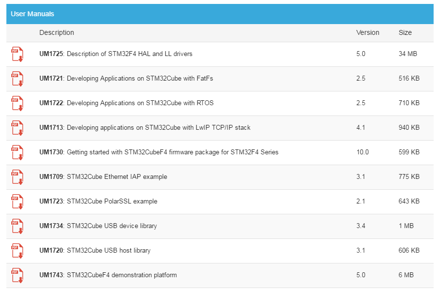

1. Getting started guideline: Where are the documentation of APIs used in the CubeMux?
A set of user manuals is provided under this link :
toget started with the STM32CubeF4 firmware package2. There is a DFU application note, but I could not find the Firmware that actually runs on the STM32 micro to perform bootloader update.
STM32Cube_FW_F4_V1.0\Projects\STM324x9I_EVAL\Applications\USB_Device\DFU_Standalone :This is a typical application on how to use the STM32F4xx USB OTG Device peripheral to implement the DFU capability for programming the embedded flash memory of the STM32F4xx devices.
