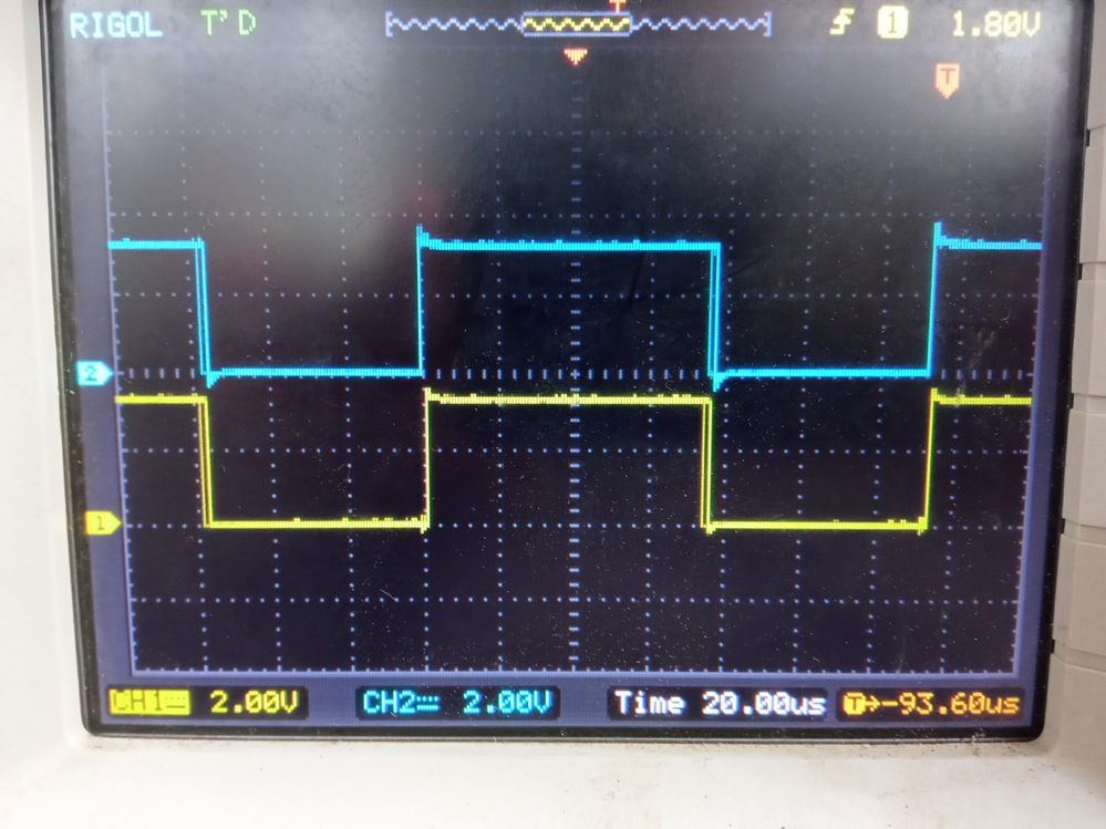

I have set Timer 8 to PWM Generation CH2 CH2N. Based on the value read by the ADC, I want to change the polarity of both CH2 and CH2N. I have found that using
__HAL_TIM_SET_CAPTUREPOLARITY
, I could change the polarity of CH20693W00000NqkcWQAR.jpg but the polarity of CH1N remains the same as shown in the image. So how could I change the polarity of both CH2 CH2N ?

Ufff.... sorry.... CCxNE is the Enable bit for the TIMx_CHxN channel. Polarity is swapped using the CCxNP bit:
TIM8->CCER |= TIM_CCER_CC2NP;
PWM channel of CH2N got inverted, but it didn't work for CH2. Also, I need toggle between non-inverted and inverted PWM based on the value read from the ADC. How can i do that ?

waclawek.jan
As I said like 3 posts ago, it's CCxP for the TIMx_CHx and CCxNP for TIMx_CHxN.
TIM8->CCER |= TIM_CCER_CC2P;
