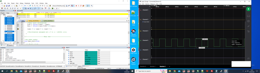

Output 1: ARR 65535

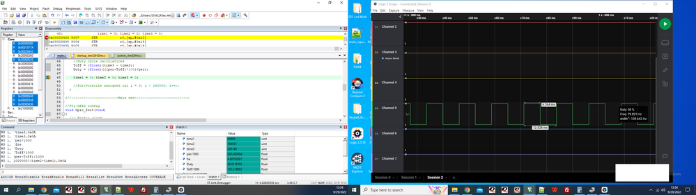

0693W00000UFPV9QAP.pngOutput 2: ARR 0xFFFFFFFF
HB
Please note that I have not changed ARR once the timer start.
