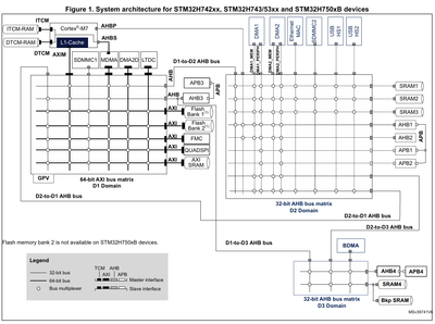

I am designing a high-speed data logging architecture using STM32H743VIHx. I would like the community to validate my DMA architecture and answer specific questions about eMMC access. I did not find answers in the forum and I am also not an expert in microcontroller hardware/software architecture.
--- SYSTEM OVERVIEW ---
The logging produces a continuous signal sampled by the ADC. I need to log raw data samples along with GPS and IMU data to an eMMC for post-processing.
Key parameters:
- ADC: 14-bit dual interleaved on PA6 (ADC12_INP3), differential ~10 MSPS effective
- eMMC: S32 GB, eMMC 5.1
- SDMMC1 in 8-bit MMC mode
- IMU: on SPI2 (PB12-15) at 8 kHz
- GPS: on UART4 at 115200 baud
--- PROPOSED DMA ARCHITECTURE ---
Four concurrent DMA paths:
1. ADC1+ADC2 interleaved → DMA1_Stream0 → AXI SRAM (ping buffer)
Triggered by ADC1 EOC, reads CDR register (32-bit = 2 interleaved samples)
Rate: ~20 MB/s
Priority: VERY HIGH
2. AXI SRAM (pong buffer) → MDMA_Channel0 → SDMMC1 → eMMC
Triggered after 128 consecutive measurements
Burst write: 2.56 MB per transfer
Rate: ~45 MB/s burst
Priority: HIGH
3. SPI2 → DMA1_Stream4 → AXI SRAM (IMU buffer)
Triggered by IMU INT1 at 8 kHz
Rate: ~1 MB/s
Priority: MEDIUM
4. UART4 → DMA2_Stream2 → AXI SRAM (GPS buffer)
Circular DMA, UART idle detection
Rate: ~14 KB/s
Priority: LOW
Ping-pong buffers in AXI SRAM, 32-byte aligned, DCache cleaned before MDMA read.
--- QUESTIONS ---
Q1 - ADC dual interleaved validation
Is PA6 (ADC12_INP3) a valid fast channel for dual interleaved differential mode at 10 MSPS / 14-bit on the STM32H743VIHx ? AN5354 states 10 MSPS at 14-bit is achievable on fast channels but does not list specific pins for the 100-pin package. I have seen a community post confirming ADC12_INP3 (PA6), ADC12_INP4 (PC4), and ADC12_INP5 (PB1) as the only fast channels.
Q2 — DMA parallelism
Can DMA1_Stream0 (ADC→SRAM) and MDMA_Channel0 (SRAM→SDMMC) run simultaneously without stalling the ADC path? My AXI SRAM load calculation gives ~66 MB/s total against ~960 MB/s realistic bandwidth — well within limits. However I am concerned about bus arbitration causing microsecond stalls on the ADC DMA during MDMA burst writes. Has anyone experienced ADC sample loss during simultaneous MDMA eMMC writes?
Q3 — eMMC offline readout via USB
After the flight I need to read the raw eMMC data on a PC for post-processing.
Can I implement USB MSC using the H743 USB OTG FS on PA11/PA12. The STM32 reads eMMC via SDMMC1 and exposes it as a USB drive. Is it possible ? What component do I need to add ?
Q4 — eMMC raw sector access without filesystem
I am writing raw sectors directly (no FatFS) using HAL_MMC_WriteBlocks_DMA for performance. After plugging via USB MSC, will the PC see the device as a raw disk ? Or does USB MSC require the device to have a valid MBR/partition table?
Thank you for any feedback. I am really not an expert in this domain and I tried my best to gather informations. But I am not 100% sure of what I found as it is a mix of forums answers, datasheets and Claude AI help.

Thank your for the reply. Is it possible to know what you had in mind with DTCM and ITCM please ?
I really don't see how ADC+GPS+IMU can use them efficiently. Don't ADC goes to DMA - AXI SRAM - eMMC ?
I don't know when data comes to CPU as I don't have functions or so. I just read ADC and save it

Everything is clear except the SRAM regions. I wanted to know if separating SRAM regions can solve the issue ?
If not, is it possible to know (if it is possible) how to handle ADC save to eMMC at 10MSPS with IMU and GPS at lower rate (1-10Hz) ?

It is recommended to move CPU code to ITCM and stack, and control variables to DTCM. For DMA buffers, keep them in DMA accessible RAMs such as AXI SRAM
Separating SRAM regions can help only if it reduces bus contention when mapping to different internal bus paths.
I suggest you checkin app note AN4891 and X-CUBE-PERF-H7

If I can ask a last question before closing the thread, this solution has an advantage if there is a code and variables, no ? What if I only use the STM32 to log its ADC to the eMMC as well as GPS. The code is minimal, I do not understand if it is a real advantage in my case.
