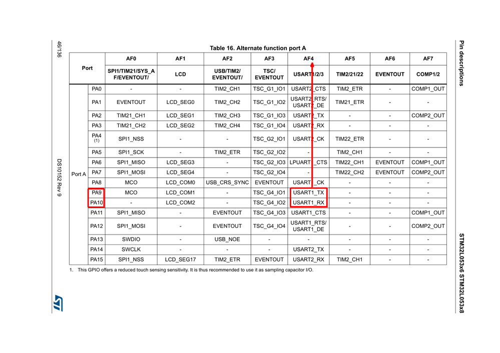

Hi In the STM32L053R8 Datasheet, I cannot figure out the default alternative function AF0, AF1... I'm using the UART TX RX on PA10 PA9 is that the correct choice?
BEKABEN
AF4 is set by software.
If you used PA9/PA10 for a UART connection in your design it will be usable as such.
F​or the System Loader see App Note AN2606 for supported PINS and METHODS.

Hello @BEKABEN​ ,
Correct, for UART instance 1 : PA9/PB6 -> UART1_TX and PA10/PB7 -> UART1_RX
For LPUART : PB10/PC4/PC10 -> LPUART1_TX and PC5/PC11 -> LPUART1_RX
Also, for UART instance 2 : PA2/PA14 -> UART2_TX and PA3/PA15 -> UART2_RX
Foued
waclawek.jan
Yes
is AF4 the default setting on the stm32l053r8?
waclawek.jan
No.
Default setting of all AF is AF0 - see GPIO_AFR registers description in the GPIO chapte of Reference Manual.
BEKABEN
If I design my schematic based on AF4 and I'm accessing the UART from PA9 PA10 is it possible to do updates in the future?
