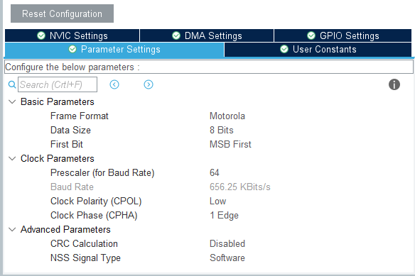

hi iam trying to interface stm32f4 discovery board with ADC IC ADS8320. the maximum spi clock that can be given to ADC IC is 2.4MHz. But when i try to reduce SPI clock frequency to 1MHZ(using the external cystal given in board as clock source.)
Vk.2
the uart stops working and code gets stuck. Can anyone tell me why this is happening?

How is the SPI clocked, exactly? If you're tapping the board source are you distorting or stopping it?
The SPI peripheral has a prescaler, but the frequencies you can hit are limited by the APB source. You might have to adjust down the AHB/CPU clock to hit specific targets.

Hi Tesla DeLorean thanks for the reply.0693W00000Dng6LQAR.pngok i will do that . In this inage there is prescalar and baud rate. my doubt is that does this baud rate reperesent the clock given by controller to slave device.
