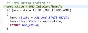

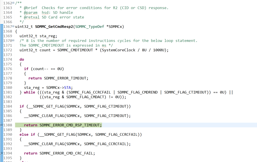

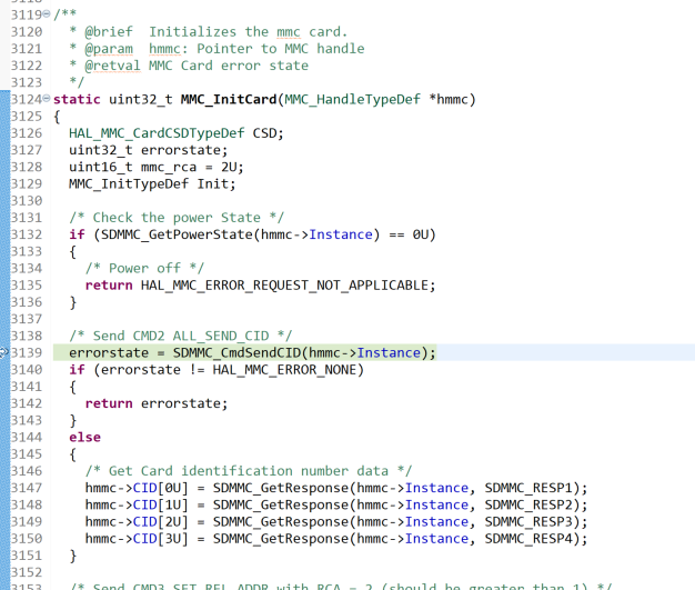

I'm trying to program eMMC card with STM32U575 but the init fonction MX_SDMMC1_MMC_Init() failes in SDMMC_GetCmdResp3(SDMMC_TypeDef *SDMMCx) and return SDMMC_ERROR_CMD_RSP_TIMEOUT.
Any idea?

What clock rate are you using? Might try slowing it down by an order of magnitude to see if results change. If so, the culprit is likely the slow and poorly done HAL eMMC library.

The first command gives response when I cup the power and put it back but the second one never give response

Not sure screen shots of library code are the path to success here.
2021-12-17 7:49 AM
2021-12-17 7:50 AM
2021-12-17 7:50 AM
Maybe you can see the problem with that.
