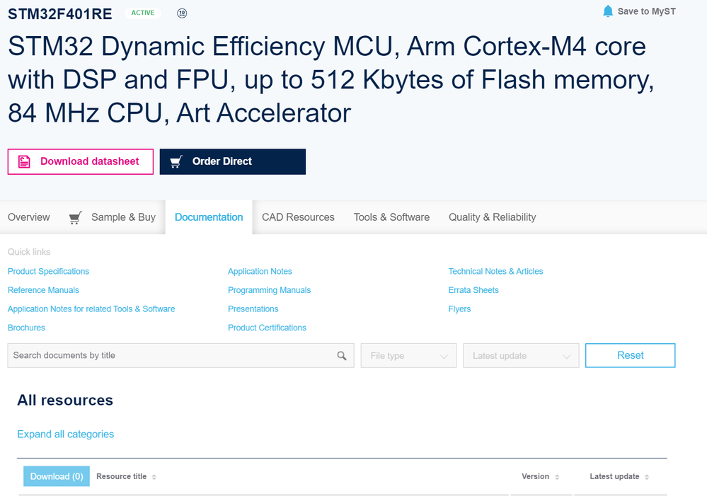

FBL
Hello @AAzda.1​ & welcome to ST Community,
You can find the documentation related to the microcontroller at this link.
_legacyfs_online_stmicro_images_0693W00000bhfFzQAI.pngAlso, here you can find documentation related to the board.
Hope this helps!
