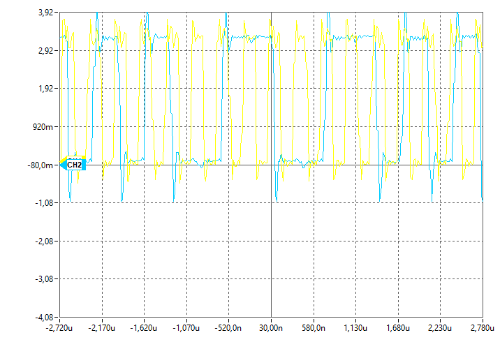

Dear Readers,
I got a lot of problems getting a PDM microphone (IM69D130) via SAI running on an STM32L431. I connected it as specified in app Note AN5027 (Select --> HIGH; Clock --> SCK_A; DATA --> SAI_SD_A);
SAI_1 has 32 MHZ.
Sai_init:
hsai_BlockA1.Instance = SAI1_Block_A;
  hsai_BlockA1.Init.Protocol = SAI_FREE_PROTOCOL;
  hsai_BlockA1.Init.AudioMode = SAI_MODEMASTER_RX;
  hsai_BlockA1.Init.DataSize = SAI_DATASIZE_16;
  hsai_BlockA1.Init.FirstBit = SAI_FIRSTBIT_MSB;
  hsai_BlockA1.Init.ClockStrobing = SAI_CLOCKSTROBING_FALLINGEDGE;
  hsai_BlockA1.Init.Synchro = SAI_ASYNCHRONOUS;
  hsai_BlockA1.Init.OutputDrive = SAI_OUTPUTDRIVE_DISABLE;
  hsai_BlockA1.Init.NoDivider = SAI_MASTERDIVIDER_ENABLE;
  hsai_BlockA1.Init.FIFOThreshold = SAI_FIFOTHRESHOLD_FULL;
  hsai_BlockA1.Init.AudioFrequency = SAI_AUDIO_FREQUENCY_8K;
  hsai_BlockA1.Init.SynchroExt = SAI_SYNCEXT_DISABLE;
  hsai_BlockA1.Init.MonoStereoMode = SAI_STEREOMODE;
  hsai_BlockA1.Init.CompandingMode = SAI_NOCOMPANDING;
  hsai_BlockA1.FrameInit.FrameLength = 64;
  hsai_BlockA1.FrameInit.ActiveFrameLength = 32;
  hsai_BlockA1.FrameInit.FSDefinition = SAI_FS_CHANNEL_IDENTIFICATION;
  hsai_BlockA1.FrameInit.FSPolarity = SAI_FS_ACTIVE_LOW;
  hsai_BlockA1.FrameInit.FSOffset = SAI_FS_FIRSTBIT;
  hsai_BlockA1.SlotInit.FirstBitOffset = 0;
  hsai_BlockA1.SlotInit.SlotSize = SAI_SLOTSIZE_DATASIZE;
  hsai_BlockA1.SlotInit.SlotNumber = 4;
  hsai_BlockA1.SlotInit.SlotActive = 0x0000FFFF;

I tried to see a sine wave with 100hz but nothing shows up. Did i make a mistake somewhere?

Observe the waveforms on the pins, using oscilloscope or better, LA.
Read out and check/post content of relevant GPIO and SAI registers.
Christian Pommer
The Signal does not look unusual. Could it be, that i use the wrong clock strobe? I only got one microphone.0693W00000AMH0qQAH.png
Read out and check/post content of relevant GPIO and DMA and SAI registers.
Check the raw data in DMA buffers.
