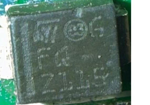

Identify this component?
‎2025-06-01 10:58 PM - last edited on ‎2025-06-02 2:47 AM by Andrew Neil
‎2025-06-01 11:19 PM
SM6T68A
Datasheet - SM6TxxA, SM6TxxCA - 600 W TVS in SMB
The relevant marking is "FQ" here.
Can be bought from any supplier. Here is one
SM6T68A STMicroelectronics | Circuit Protection | DigiKey
