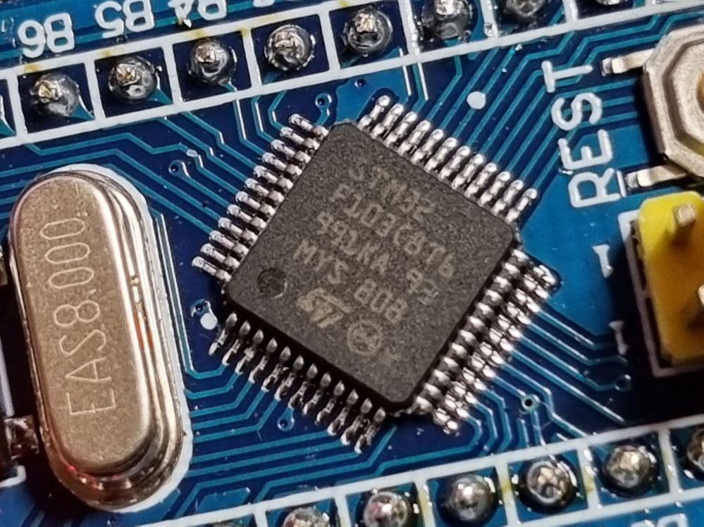

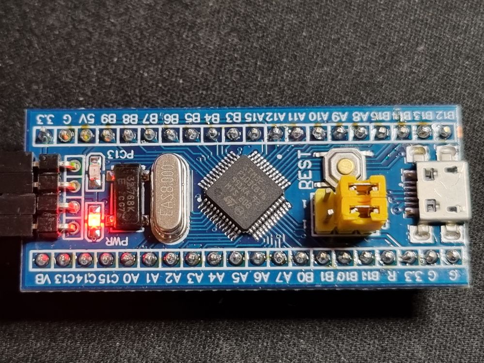

STM32F103 Bluepill?
This has been discussed here many times. I would not be surprised if this is also due to the STM32F103 counterfeits that have been used on the Bluepills for a long time, i.e. they are usually not original parts from STMicroelectronics.
There are many websites that have already dealt with this topic, e.g. hackaday.io or eevblog.com.
Regards
/Peter
Watch that the F103 can't do USB and CAN concurrently as they share a RAM buffer and conflict.
AFIO clock needs enabling if pin remapping is used.
I have heard about counterfeit chips. Never crossed my mind though this time, as I bought the boards from a reputable (?) source in Germany ("Bluepill" Development Board Modul mit ARM Cortex M3 Prozessor – AZ-Delivery).
Would they be selling boards with counterfeit chips?
This is the board I have (I have 3 of them).
