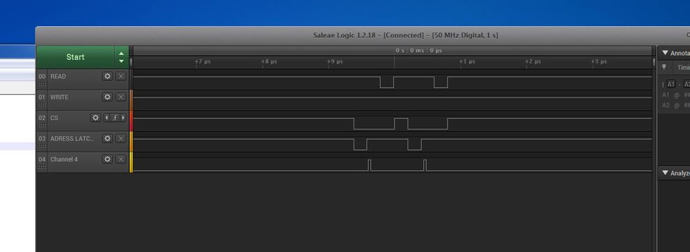

I have hooked up all the hardware wiring between the FPGA and ARM and guess what, as usual really really strange thing happening ?

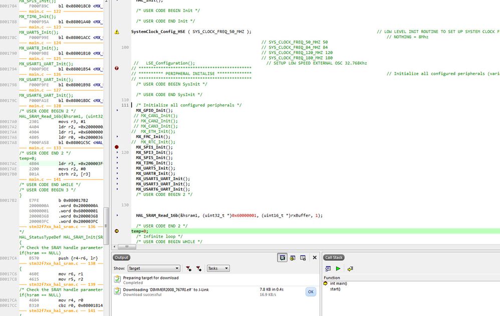

why when I use
 HAL_SRAM_Read_16b(&hsram1, (uint32_t *)0x60000001, (uint16_t *)rxBuffer, 1);
I get two chip selects and two reads
Yet when I read 60000000 I only get one CS and one read, WHAT IS GOING ON ???
 HAL_SRAM_Read_16b(&hsram1, (uint32_t *)0x60000000, (uint16_t *)rxBuffer, 1);
Both these above HAL_SRAM_Read commands should simply read back ONE 16bit (2byte) data from the selected address
but anything above 0x60000000 does 2 chip selects and two reads of the data

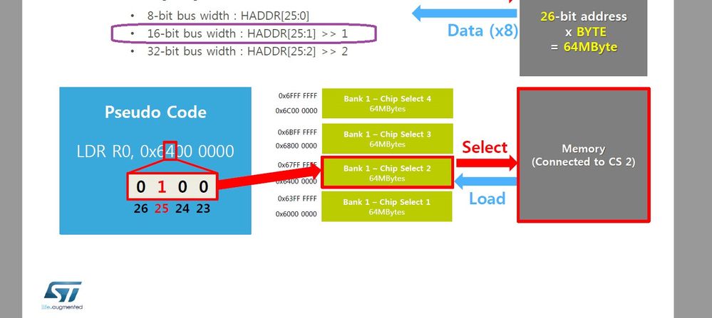

>>so am I correct in thinking
 0x60000000 = address 0 inside my FPGA
 and 0x60000001 = address 1 inside my FPGA
 and 0x60000002 = address 2 inside my FPGA
NO

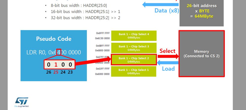

With a 16-bit DATA BUS the DEVICE addresses as WORDS
 0x60000000 = address 0 externally
 and 0x60000002 = address 1
 and 0x60000004 = address 2
>>sorry really confused are you saying it reads two lots of 8bit data consecutively thus the two cs lows ??
EVEN WORDs will go to your device directly
ODD ADDRESSED WORDs will span TWO WORDs in your DEVICE
0x60000001 will pull HALF of WORD 0, and HALF of WORD 1
BYTEs are manage via BYTE LANES. A Barrel shifter on the input to extract a 8-bit byte from the word, and a LOW/HIGH Byte Lane select for writes to a single byte within the word.
ST Shifts the Internal Address Space to the External Bus, at 16-bit, ie IntA1 -> ExtA0
