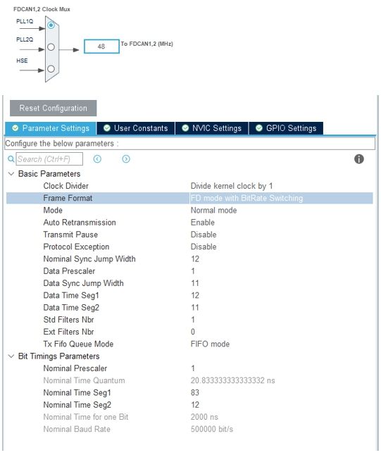

FDCAN does not work.
Please advise if there is any problem in the entire code below.
The set clock of FDCAN is 48Mhz and each setting is as follows.
_legacyfs_online_stmicro_images_0693W00000bi15kQAA.pngWhen the code is executed, Tx is transmitted once every 4 seconds in the while loop.
However, if Tx is entered about 4 times, it always falls into Error_Handler.
Error returns Error at the bottom of HAL_FDCAN_AddMessageToTxFifoQ function.

Another important clue is that if you change just one line of frameformat to FDCAN_FRAME_CLASSIC in the entire code, it will operate normally with CAN2.0 (not FDCAN).
hfdcan1.Init.FrameFormat = FDCAN_FRAME_FD_BRS; -----------> hfdcan1.Init.FrameFormat = FDCAN_FRAME_CLASSIC;

Not sure if I remember the following correctly from H7 FDCAN:
I think the TX FIFO can hold 4 messages.
The TX FIFO auto-clears with certain settings only if it receives an ACK from any receiver.
So, you sure that the receiver supports bit rate switching at 2 MHz?
If not -> no ACK -> TX FIFO full after 4 messages

Thank you for your reply.
There was no problem with the code I posted.
However, the message about TX FIFO full was ignored.
And the problem of not reading the message properly was that the CAN analyzer I used had a problem reading CANFD.
