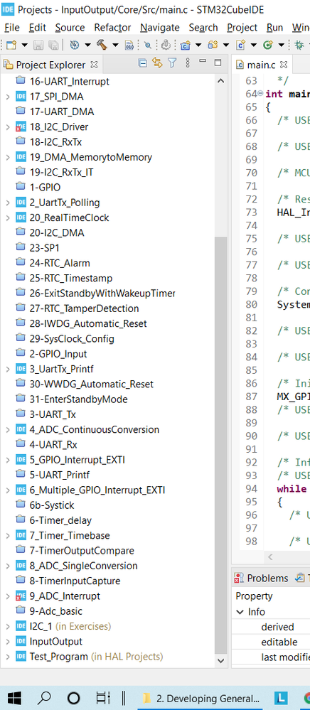

Hello there, in my project explorer, the projects pilled up quite(see picture) a bit and it's annoying when i have to find the existing project from the list. Is there a way to manage them, to create folders where i can group them?

Read on “working sets�? in Eclipse.
Piranha
Chief II
https://dzone.com/articles/eclipse-working-sets-explained
So the Eclipse forcefully shows everything and then one has to particularly set up some inconvenient filters to see only the things one actually needs... Isn't it obvious to Eclipse developers and users that it's backwards and unproductive? How about the "revolutionary" idea of showing only the specific projects one has opened? You know... Like, for example, it's done in a most other IDEs...
