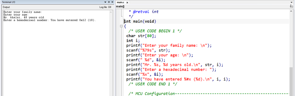

the correct code would be:
scanf("%79s", &str);
Scanf did not consume the \n character that stayed in the buffer from the first scanf call.
So the second scanf call did.
You have to clear the stdin before reading again or just get rid of the newline.
The second call should be.
scanf(" %d",&i);
Foued
HA.5
i used exactly the same what you wrote here, it doesn't work, i don't know, maybe i need interrupt here for scanf, otherwise i have no more idea
Foued_KH
Hello @HA.5​ ,
I have tested your code, It worked correctly :

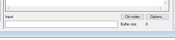

_legacyfs_online_stmicro_images_0693W00000bka3lQAA.pngI think you should entre your inputs when debug :
