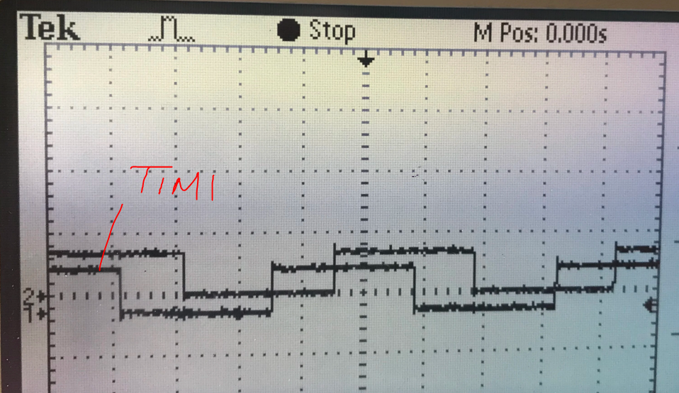

hello is there a function among the HALL functions that allows me to move the TIM1 output on the X axis through a potentionometer
abodi.1
1 REPLY 1
Sarra.S
Hello @abodi.1​,
No, there is no ready-to-use HAL function to vary a PWM signal through a pot
You need to connect the pot to an ADC_IN and then in the HAL_ADC_ConvCpltCallback, read the ADC value and vary the duty cycle.
