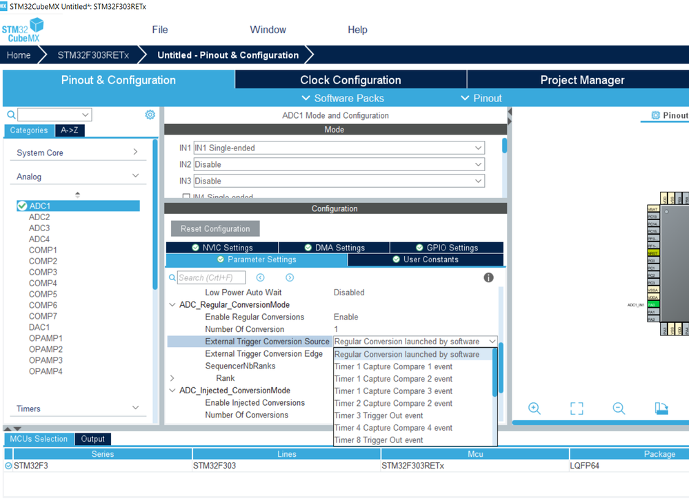

Hello Everyone, Please is it possible to trigger an adc conversion in DMA mode using external interrupt from gpio pin . I am using stm32f303re.

Yes it is.
0693W00000FDP6KQAX.pngIn CubeMX you can see what external triggers could the ADC have.
Im sure there is a better way to address your problem but you could trigger the ADC with a "Regular Conversion Launched by software" inside your EXTINT callback
Then you can just configure the DMA to take care of the ADC readings as they come
