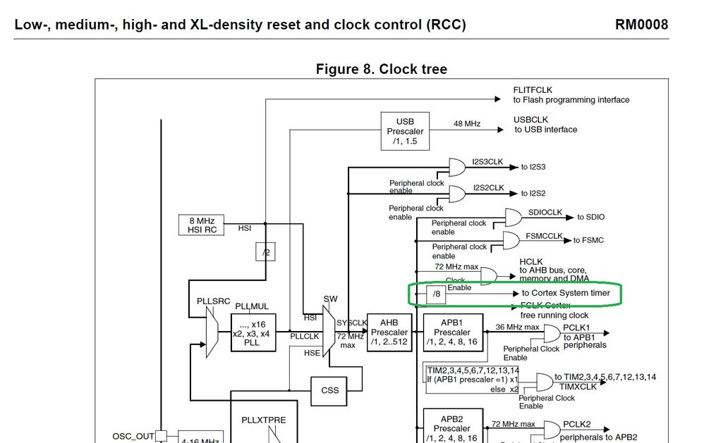

Hi. I am a little bit confused after reading Reference Manual.
What is the difference beteen HCLK and SYSCLK?
Which clock is used to feed MCU Core?
When we talking about time to execute instruction which clock cycle does it concern?

    This can probably best be seen with the Clock Configuration View in STM32CubeMX.
    SYSCLK is the output of the clock multiplexer, which is clocked by clock sources such as HSI, HSE or PLLCLK. HCLK is then derived from SYSCLK, but by a prescaler of 1:1...1:512.
    However, this scheme can vary depending on the STM32 family and use different naming conventions.
    Depending on the specific family the MCU core is usually clocked by HCLK. Therefore, when we talk about the time to execute instructions, we talk about the HCLK clock cycle.

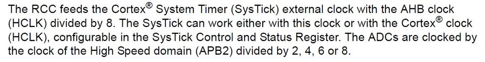

    >>The SYSTICK is normally clocked at SYSCLK/8 or SYSCLK on STM32 designs.
    This is not always, i thing. Because in f103 and f411SYSTICK is clocked from HCLK according to CubeMX
