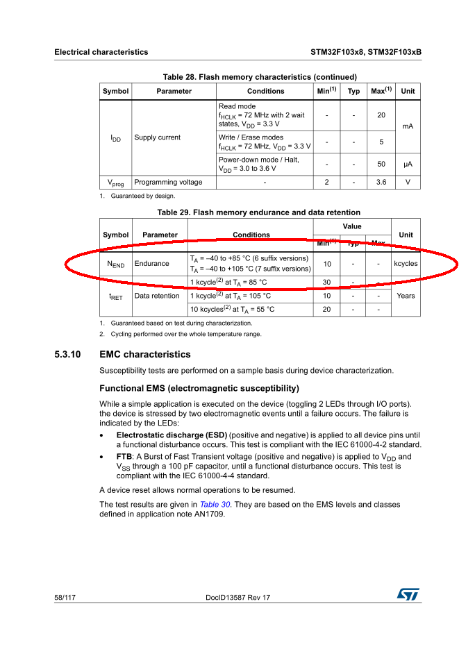

How many times write flash memory with stm32f103c8
SKim.1761
Now I am using stm32f103c8 and i'd like to write flash directly in launch period
So I did make it write erase and read data using Hal_functions as you can see under

But I don't know How many times it would be endure
About 100 series? or 10000 over?
regards

waclawek.jan
0693W00000AMAl1QAH.pngJW
SKim.1761
Thankyou ​i acted like finger princess..
