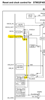

STM32F4 - MCO1 gives SYSCLK when asked for PLLCLK
fufu930
On STM32F4, when you choose PLLCLK as the MCO1 source, does the HAL actually routes the PLL output going into SYSCLK, i.e. after the PLLP division?

    HAL_RCC_MCOConfig(RCC_MCO1, RCC_MCO1SOURCE_PLLCLK, RCC_MCODIV_1);
Per the reference manual, yes. It outputs PLLP. This may or may not be SYSCLK, depending on the system clock mux.
1 REPLY 1
