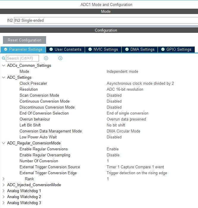

I'm running ADC 1 in DMA mode with data stored in an array variable.
The ADC is triggered by the 5 Capture/Compare Update events from Timer 1.
The DMA is set up to store the data in an array.

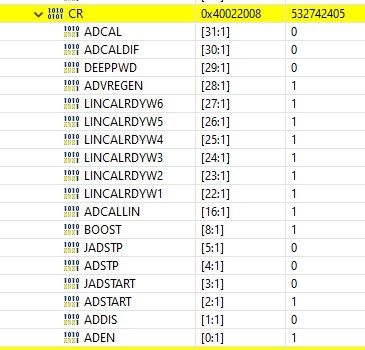

Observe ADC registers in debugger. While this might be intrusive and stop the stream of conversions (I'm not sure, ADCs are very complex and they vary across STM32 families a lot), you should see at least one converted output in the ADC data register.

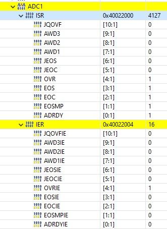

Register ADC1 - DR - RDATA is changing correctly with changing input voltage - showing that data is being produced by the ADC.
This would indicate that the ADC is being triggered properly by Timer 1 - so no need to look at Timer 1 (or timer 3) registers as they seem to be working properly.
Register DMA1 - S0NDTR - NDT has a value of 4 and does not seem to changing.
ADC Registers:

First, read the DMA-related sections of Data management subchapter of ADC chapter. Check the ADC registers if they are set up properly for DMA, and if there's no status blocking further conversion and/or DMA triggering.

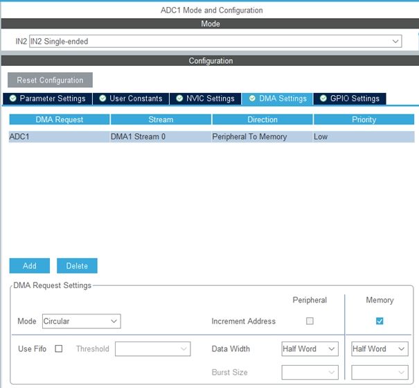

ADC1 uses DMA1 Stream 0
It does not appear that any of the required DMA control bits are set to 1.
I don't understand why.

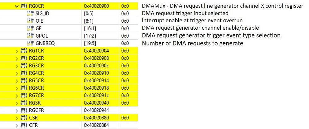

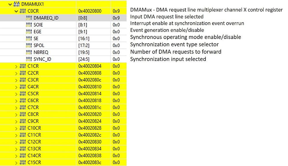

DMAMUX is a complex machine of which you probably don't use nothing just the plain routing provided by the DMAREQ_ID field, which is filled in - just check if that value corresponds to ADC request, in table at beginning of the DMAMUX chapter.
