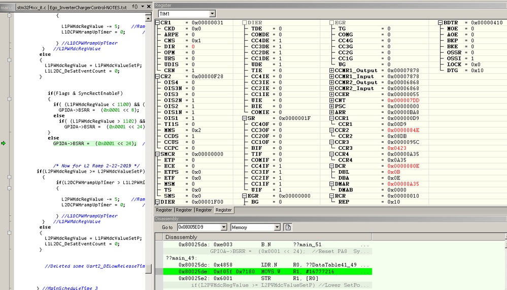

OK, NOW, trying to get DMA2 to do what I want to, I find that the TIM1 MOE output enable DISABLES itself (also AOE) when the REP RCR count is done.
The reasons I see for this in the documentation are when a BREAK is generated in TIM1. ALL my break generation bits are zero. I'm not even sure
what break means ?
MOE will stay high and output continue pulses only if I set DMA not to update the CCRx registers.
Is there another reason that MOE might go low besides dead time generation DTG or break that I am not seeing in the documentation maybe ?
This MAY be related to DBM double buffer mode which is really what I would like to have working so I can update waveform table based on CT status.
Also, I thought there was a way to stop the timer only after the NDTR in Sream register went to zero. Is that still true ? I would like to have an entire half cycle of my waveform table pulsed out of TIM1 and TIM8 before getting an interrupt.

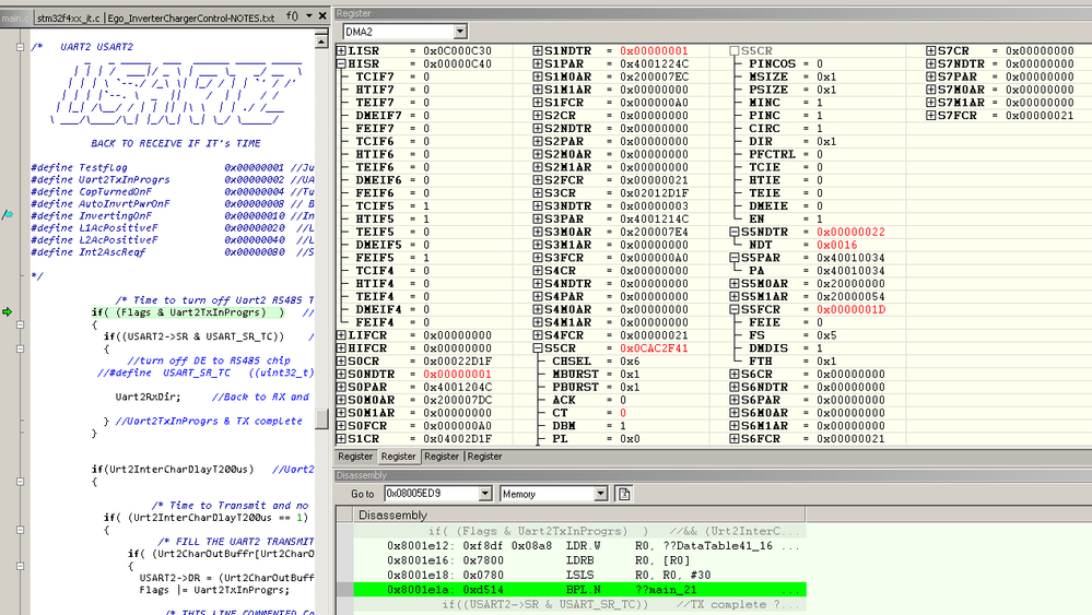

There are several things I could upload but a couple of debug captures of registers might be useful to add to my ********...
EDIT: JUST noticed I am getting some DMA2 Stream 5 error flags. THAT will disable my stream... BUT should not have any effect on the TIM1 MOE output enable bit as far as I can see with the documentation.
The DMA2 Stream 5 registers expanded ... Not my end DMA mode necessarily, just some of what I am getting.
The Timer 1 registers after a typical DMA trigger.
To get the red updated numbers, I have to hit F5 again but that's OK.

waclawek.jan
Don't use bursts until you *exactly* know what are you doing, especially on the peripheral side. Maybe refrain from using FIFO at all, for a safe starting point; there are alignment constraints for using FIFO/bursts which may not be obvious at the first sight (read the documentation very, very, very carefully if you really think you need to use them).
But the main problem is, that you use increment on the peripheral side, it means, that you write the first transfer into the DMAR register, but each subsequent writes go further and further up in the TIM registers area, until it overwrites the register containing MOE.
Note what have I said on viewing the pointer registers in DMA in my previous post.
