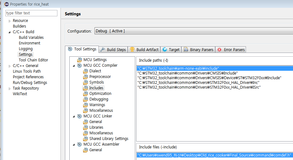

In the project properties setting, I am using arm-none-eabi-gcc toolchain.
This time toolchain is Ac6 STM32 MCU GCC and builder CDT internal.
Problem is if I add h files in HAL library that error log suggest me to do, it solved and if I build project again it shows the problem in CMSIS include H files.
Such as,
1. C:\STM32_toolchain\common\Drivers\CMSIS\Device\ST\STM32F0xx\Include/stm32f0xx.h:187:3: error: declaration for parameter 'FunctionalState' but no such parameter
} FunctionalState;
..\inc\Src\stm32f0xx_hal_flash_ex.c:990:1: error: expected '{' at end of input
..\inc\Src\stm32f0xx_hal_flash_ex.c:990:1: warning: control reaches end of non-void function [-Wreturn-type]
APIs, Headers,state machine files are exists in Project branch, but why the compiler showing errors in H files of driver ?
Looking at C code structure related reason, yes I found some style of C coding in CMSIS h files is different.
what should I do now?
1. CDT does not showing errors of my main files, there was a return type problem, I solved it.
3. I think compiler is compiling all files listed in project branch , do you want me to remove some of the files from project folder, is it repeating again as I include paths from C driver?
4. Is there any setting for which only compile my c file?
5. Do you believe, updated version of Java/gcc/Eclipse is needed ?
I am using this HAL driver STM32Cube_FW_F0_V1.6.0 downloaded from STM website.
Hope you will give me some good suggestions.
Regards
HASAN

Posted on November 16, 2016 at 16:28
It still sounds like you don't have the Include Paths set correctly, and I really can't tell what you actually have set up as you don't provide any screen shots to be able to validate your assertions that it is as it should be. This list of paths may well contain a half-dozen directories that the compiler searches in order for ''foo.h'', etc. If it can't find the file it is because it is being told to look in the wrong places.
General rules for Keil are that your paths should not be off the Desktop or other virtual directories, should not contain odd characters and/or hieroglyphs, and should avoid spaces or things that could be misinterpreted.
Md Mubdiul Hasan
Posted on November 17, 2016 at 02:49
Dear Sir AvarTar,
My apologies for misinterpreting things which should be explain  correctly.
The options for target, I did connect the folder not files.
Yes, I did copy that file in the HAL library folder and still its unsolvable.
From now on, I will carry my question in Eclipse based.
There might me some issues relating the project setting, and may be I am adding same files which already exists in my project try or include path folder!

AvaTar
Lead
Posted on November 17, 2016 at 07:59
Viewing the image you posted, the path separation characters don't look good.
When I look at my configurations, it's either '\' or '/'.
Md Mubdiul Hasan
Posted on November 17, 2016 at 09:05
Dear Sir AvaTar,
Do you mean its should be with a bar like / ?
Or do you mean in this way... 'C:\STM32_toolchain\common\Drivers\CMSIS\Device\ST\STM32F0xx\Include'?
Have you see other setting which I have been attach in this before this conversation?
Regards
Hasan
AvaTar
Lead
Posted on November 17, 2016 at 10:34
That is how it looks like on a Windows platform.
Other platforms (Unix and Unix-like's) use the (forward) slash.
Eclipse is platform-independant and can deal with both, especially with '/' on Windows platform.
I have the suspicion your ''missing'' file is the very first include file the toolchain is going to search.
Can you post the full build log (including the call command line) ?
In Eclipse, it is the output that ends up in the ''Console'' window.
