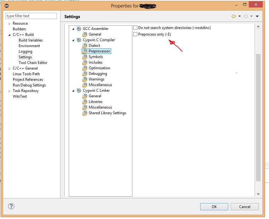

> ..\inc\Src\stm32f0xx_hal_flash_ex.c:990:1: error: expected '{' at end of input
I would try adding the ''-E'', and view the preprocessed output the compiler would see.

> 2. Where you wanted to adding -E?
> 3.Preprocessed output setting is where?
On a plain Eclipse it looks like this (right-click on the project, select ''Options...''):
The generated (preprocessed) source ends up somewhere in the Debug sub-path (for the Debug build).

Looking at your suggestion, I have change the setting. Now  the console says,
Info: Internal Builder is used for build
arm-none-eabi-gcc -mthumb -mfloat-abi=soft -E ''-IC:\\STM32_toolchain\\arm-none-eabi\\bin'' ''-IC:\\STM32_toolchain\\bin'' ''-IC:\\STM32_toolchain\\common\\Drivers\\STM32F0xx_HAL_Driver\\Inc'' ''-IC:\\STM32_toolchain\\common\\Drivers\\STM32F0xx_HAL_Driver\\Src'' ''-IC:\\STM32_toolchain\\lib\\gcc'' ''-IC:\\STM32_toolchain\\arm-none-eabi\\lib'' -O0 -g3 -Wall -fmessage-length=0 -ffunction-sections -c -o ''inc\\Src\\stm32f0xx_hal_i2s.o'' ''..\\inc\\Src\\stm32f0xx_hal_i2s.c''

This file should be in one of the defined include paths - these are the one's given with ''
-I
'' in the console:
The stm32fxxx.h file(s) are usually to find in the folder:
...\STM32Cube_xxx\Drivers\CMSIS\Device\ST\STM32Fxxx\Include
The ''xxx'' part of this name depends on the actual device. I miss this path in your list.

Not sure how this is meant, but usually, this doesn't work.
The format of the project file(s) is highly IDE specific, and rarely do toolchains support the import of ''foreign'' formats. And I'm pretty sure Keil uVision does not support Coocox projects.
The build settings (including the list of include directories) is part of this project settings. And obviously it got ''lost'', because the build complains about basic headers not found.
I would start over, using Keil.
Pick an example project for the proper MCU. It should build out-of-the-box. Then you can remove unneeded functionality, and add your own, step by step.
Or, create a new (empty or ''hello world'' style) project for your MCU, and add your functionality.
With both ways, all the basic include folders, libraries and startup files are already defined.
I'm using CrossWorks, which is not supported directly by ST. When using any of the ST examples, I used this second way (create a new project, and just add the specific sources).
It takes me about 10 .. 15 minutes to add all files and paths.
Trying to ''tweak'' a Keil, IAR, Atollic or SW4STM project never worked for me.
> C:\Users\swend95_
?�궛
\Desktop\Old_rice_cooker\...
Not sure if the special characters in the path names make problems, too. In theory, it should not ...
