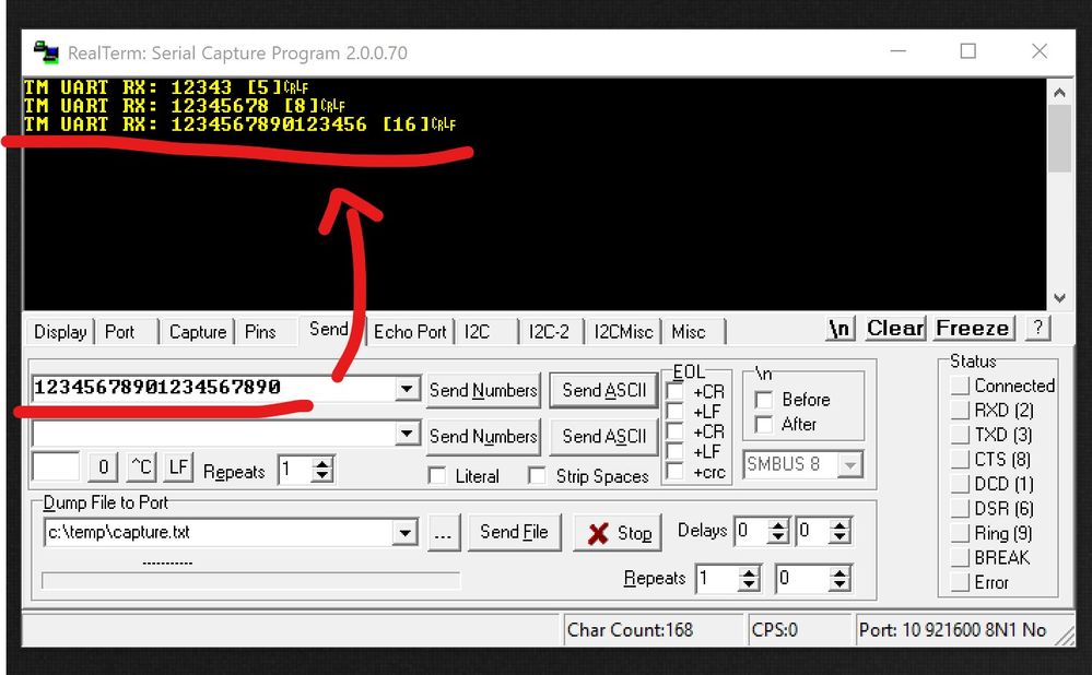

Hi, I have a problem with the HAL_UARTEx_ReceiveToIdle_DMA() function. I'm using this simple code
main.c:
#define TM_BUS_DATA_RX_BUFFER_SIZE		256
uint8_t TM_BUS_DATA_RX_BUFFER[TM_BUS_DATA_RX_BUFFER_SIZE] = {0x00};
HAL_UARTEx_ReceiveToIdle_DMA(&huart3, TM_BUS_DATA_RX_BUFFER, TM_BUS_DATA_RX_BUFFER_SIZE);
__HAL_DMA_DISABLE_IT(&hdma_usart3_rx, DMA_IT_HT);
void HAL_UARTEx_RxEventCallback(UART_HandleTypeDef *huart, uint16_t Size) {
	if( huart->Instance == TM_UART_NAME ) {
		DEBUG_MSG("TM UART RX: %s [%d]\r\n", TM_BUS_DATA_RX_BUFFER, Size);
everything works, for example I tried to send first 5 characters, then 8 characters and everything is fine, but if I try to send a package longer than 16 characters, only the first 16 characters are read and then everything freezes and no more data is received from the UART.
0693W00000LysonQAB.jpgI don't understand why everything crashes with packets longer than 16 characters since my buffer is 256 bytes. Where did this 16 byte limit come from?
Can anyone help me?

Probably HAL_UARTEx_RxEventCallback is being called on the first 16, then DEBUG_MSG takes longer than it should which causes a UART overrun, then the rest of the characters are lost.
Debug the code, hit pause when it's "crashed" and examine where the code is and the state of the UART flags, especially OVR.
I also think disabling HT is a bad idea and will cause problems, but is not the root cause of this particular issue.

> The Overrun is not a problem as my application should never receive packets larger than my buffer size.
It's not the size of the packets, it's the delay between HAL_UARTEx_RxEventCallback being called and the next HAL_UARTEx_ReceiveToIdle_DMA being started here.
> How do I know what happens after 16 bytes? What flags I can check?
As I said before:
> Tomorrow I can try to change the USB-UART converter or see what happens on the serial line with a logic analyzer, can these be useful tests?
Of course. If RealTerm has a delay after byte 16, however small, that's likely your answer.
federico.massimi
I did some testing and it seems the problem is the nucleo board VCP converter. Trying with another USB-UART converter the problem does not arise. (for now :))
At this point, however, I only have to understand why the system stops when that event occurs. In debug I saw the UART ISR register just before the  HAL_UARTEx_ReceiveToIdle_DMA function in the HAL_UARTEx_RxEventCallback, when I have the problem I see these 3 flags set: ORE, IDLE, TXFNE.
Could it be one of these that causes the uart block? I try to clear these flags before calling the  HAL_UARTEx_ReceiveToIdle_DMA function again,
__HAL_UART_CLEAR_OREFLAG(&huart3);
__HAL_UART_CLEAR_IDLEFLAG(&huart3);
and it seems that the situation has improved, could this be a stable and reliable solution?
