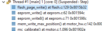

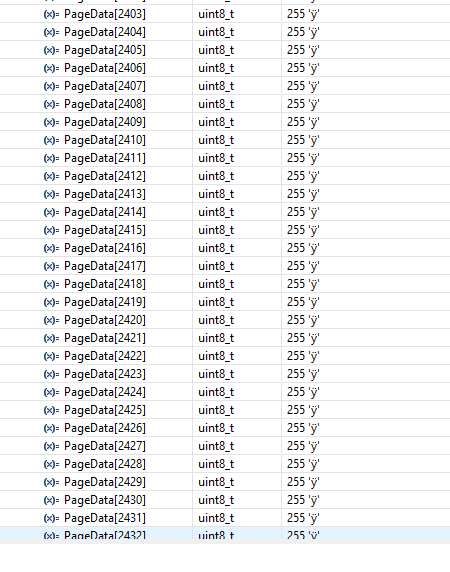

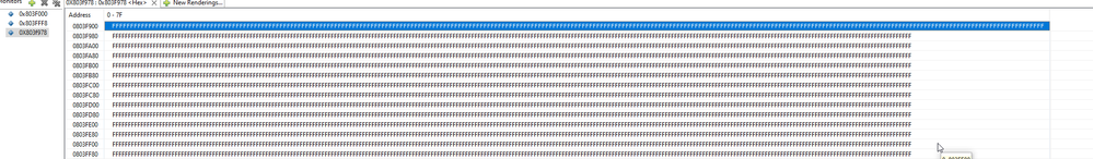

During debugging i found these locations when entering flash_page_write
PageData (0x20003660)
address (0x803f000)
