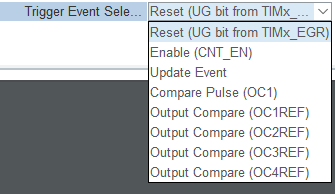

So I've created a project and am trying to use the HAL_delay(10); but it gets stuck at this function when im trying to debug.
I have been changing the clock and enabling the TIM2 so I don't know if i've messed something up. Here are the settings that I have:

Can you share your code or IOC file?
I think yo need to set your Trigger event if you want TIM2 for something
i could not replicated your issue
I set it to TIM7 where trigger is not needed.
