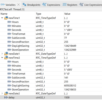

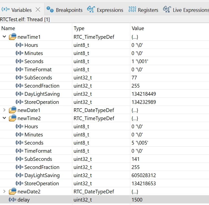

I would l have expected to see something like 4 in the newTime1.Seconds field.  The blinking LED for loop runs 6 times with a 1500 mSec delay so a total of 9 seconds which I've verified with a stop watch. So I would have expected to see something like 13 or 14 second in the New Time2.Seconds field. But here's what shows up in the Variables window.
As a test, I modified the hrtc.Init.SynchPrediv from the default 255 to 127 and see newTime1.Seconds = 4 and newTime2.Seconds=19. But 255 is supposed to be the correct value for a 32.767 kHz LSE crystal according to the Reference Manual.

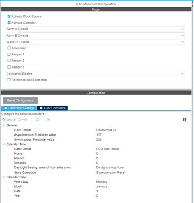

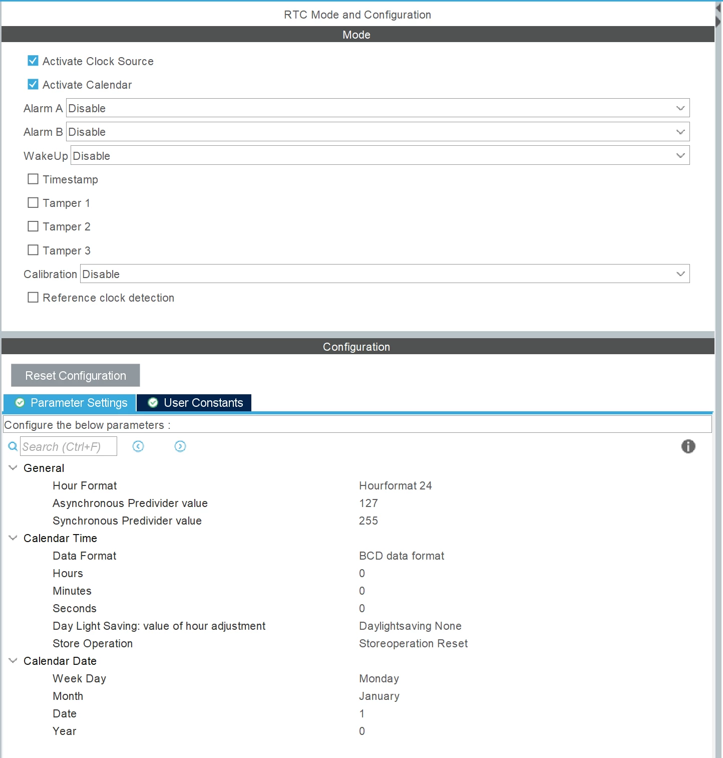

I started by creating a CubeMX project with nothing but the RTC enabled like this:

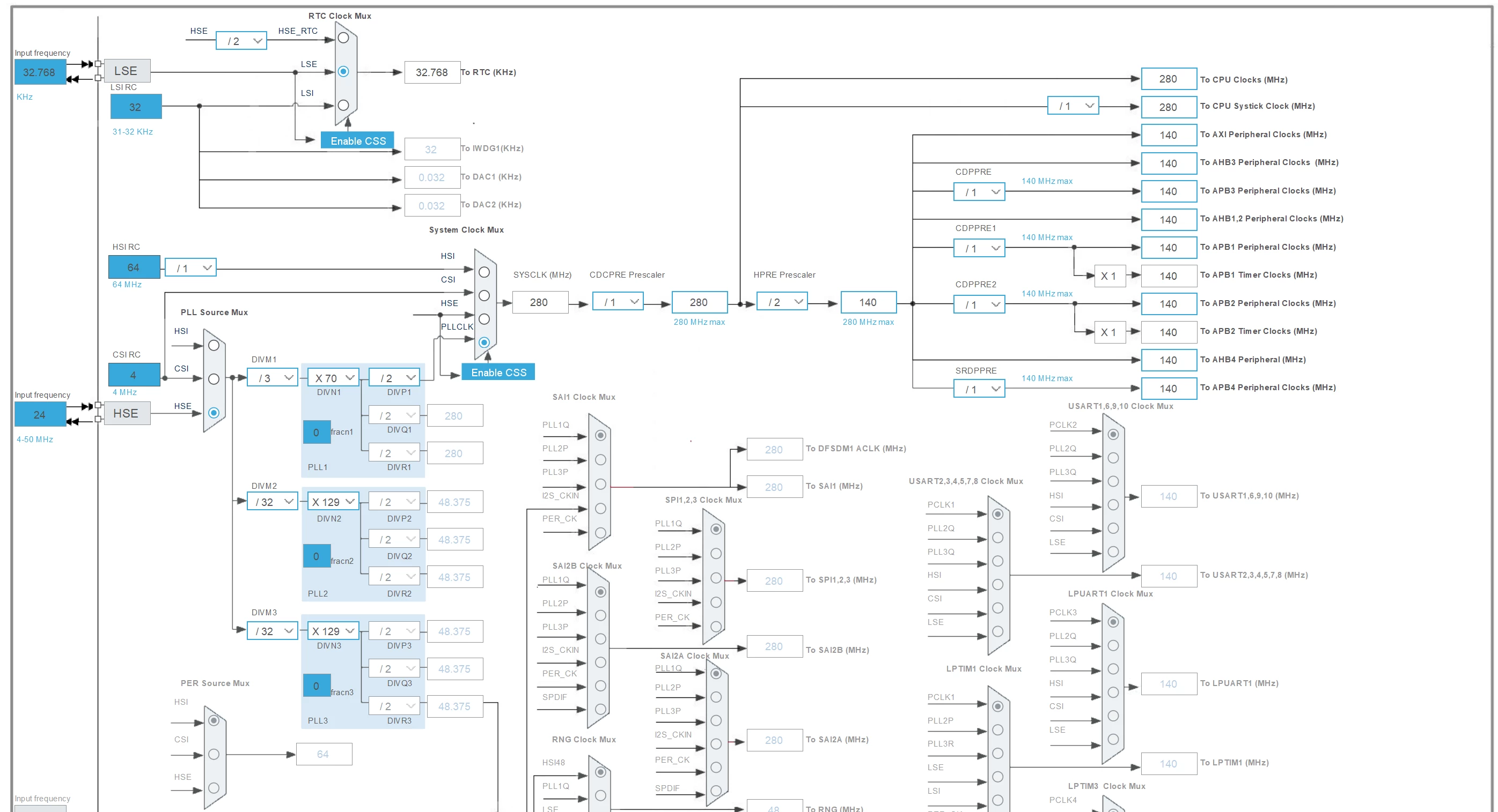

The clock configuration is this:
Any ideas on what I'm doing wrong and how to fix it will be greatly appreciated.
