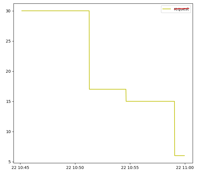

‎2021-11-22 2:03 AM
I reduced the resolution from 16b to 12b. And I let the temperature work out for a while. Here is the chart. It can be seen that it is completely wrong. I have a PCB in the office, where the temperature is about 24 deg.
uint32_t temp;
if (adc_flag >= 1){
adc_flag = 0;
if (dma_flag == 1){
temp = __LL_ADC_CALC_TEMPERATURE(VDD_VALUE, tempSensor[0], LL_ADC_RESOLUTION_12B);
UARTPrint("dma=%d, tempVal=0x%02x, temp=%d", dma_flag, tempSensor[0], temp);
dma_flag = 0;
Figure chart: yellow is temperature in degree.

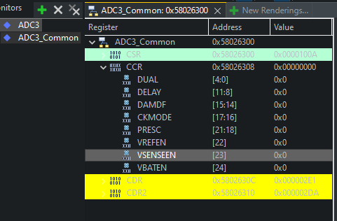

‎2021-11-22 6:25 AM
LL_ADC_SetChannelSamplingTime(ADC3, LL_ADC_CHANNEL_TEMPSENSOR, LL_ADC_SAMPLINGTIME_387CYCLES_5);
For ADC3, the sampling time need to be replaced by LL_ADC_SAMPLINGTIME_ADC3_247CYCLES_5
On other hand, can you confirm that bit TSEN is set to 1 ? It's located in ADC3_CCr register bit 23.

A can't set time to 247CYCLES_5. I don't have it in my ll file.
#define LL_ADC_SAMPLINGTIME_1CYCLE_5 (0x00000000UL) /*!< Sampling time 1.5 ADC clock cycles */
#define LL_ADC_SAMPLINGTIME_2CYCLES_5 ( ADC_SMPR2_SMP10_0) /*!< Sampling time 2.5 ADC clock cycles */
#define LL_ADC_SAMPLINGTIME_8CYCLES_5 ( ADC_SMPR2_SMP10_1 ) /*!< Sampling time 8.5 ADC clock cycles */
#define LL_ADC_SAMPLINGTIME_16CYCLES_5 ( ADC_SMPR2_SMP10_1 | ADC_SMPR2_SMP10_0) /*!< Sampling time 16.5 ADC clock cycles */
#define LL_ADC_SAMPLINGTIME_32CYCLES_5 (ADC_SMPR2_SMP10_2 ) /*!< Sampling time 32.5 ADC clock cycles */
#define LL_ADC_SAMPLINGTIME_64CYCLES_5 (ADC_SMPR2_SMP10_2 | ADC_SMPR2_SMP10_0) /*!< Sampling time 64.5 ADC clock cycles */
#define LL_ADC_SAMPLINGTIME_387CYCLES_5 (ADC_SMPR2_SMP10_2 | ADC_SMPR2_SMP10_1 ) /*!< Sampling time 387.5 ADC clock cycles */
#define LL_ADC_SAMPLINGTIME_810CYCLES_5 (ADC_SMPR2_SMP10_2 | ADC_SMPR2_SMP10_1 | ADC_SMPR2_SMP10_0) /*!< Sampling time 810.5 ADC clock cycles */
And when I look into my registers, bit TSEN I don't see. Interesting. But in my eclipse aplication it has name VSENSEEN. And it is set to 0.
‎2021-11-22 6:58 AM
I'm sorry I took the wrong reference manual...Sampling time doesn't need to be change...
Try to force this bit just before starting your ADC and see if there is any change. It seems that the TempSensor is not enable.
