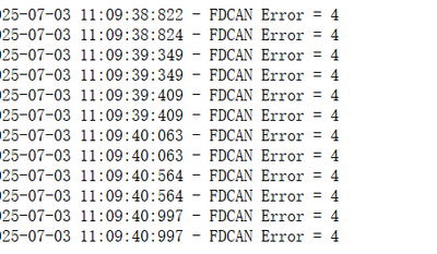

I am currently testing the hot plug of CAN. When I unplug the external CAN device, I continue to send data, but the transmission fails. When I reconnect the external CAN device, my code will report an error.
The CAN bus is designed for "static" use cases, hot-plugging is not supported.
Especially not use cases with just two nodes. Every unacknowledged transmission will cause the error count to go up, eventually causing bus shutdown (error passive , bus-off).
