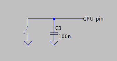

Yes, bouncing can activate any edge trigger on both, press and release of a button. Try to solve this issue first. The most common way to do it is by adding a small capacitor between GPIO line and ground or by adding a time delay after the first edge detection.
If the button press logic is still reversed after solving the bouncing issue, you can simply change the falling edge detection to rising edge. This inverted logic issue might be because of how your button outputs a signal. There is a chance that it's connected to ground when released, and to +3.3V, when pressed.
Did you try some simple "standard" way to connect a switch ?
Try with a cap:
