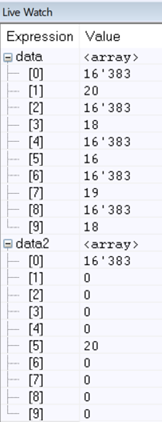

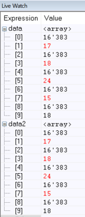

In the 2D addressing example, I configred two queues in the linkedlist. First queue is transfer the ADC samples to the buffer (data), and second queue is transfer the data to the other buffer (data2) with the 2D adressing.
My buffers (data and data2) have 10*4 sizes (uint32_t data[10]; uint32_t data2[10];).

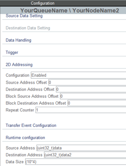

When I configured the second queue in the 0693W00000aIN34QAG.png, buffers have same 0693W00000aINCKQA4.png contents because 2D adressing is not run.

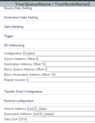

When I configured the second queue in the 0693W00000aINCeQAO.png, again 2D adressing is not run
0693W00000aIMYiQAO.png, and mcu is locked.

Also, I have two questions for you :
  • Can you please send your entire project in a zip file ? I am gonna try on my side and I want to see the channel configuration for linked list.
  • Also, Can you explain the values of the "Destination address offset", "Block Destination Address Offset" and "repeat counter" ?
Remark: on both screenshot it's written YourNodeName2.

It is true that the nodenames (YourNodeName2) in the screenshots are the same. Here i tried to present two different configurations for same node.
