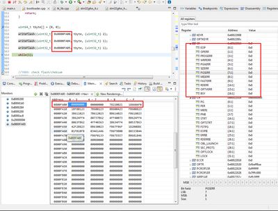

I need to check to outcome of a FLASH write operation. EOP would indicate, that it was successfully, but it needs the interrrupt to be enabled to show the outcome. Oh well, then i use the error flag instead (because i dont want to use interrupts). But then AGAIN it needs an interrupt enabled to work. Why cant there be just a simple flag without needing of other things???

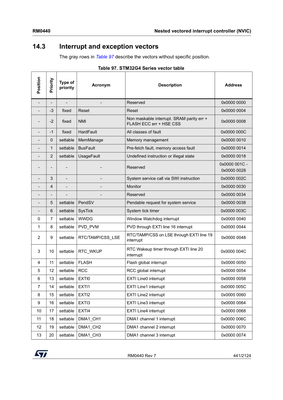

You don't need to enable the FLASH interrupt at NVIC level, so no actual interrupts will be fired.

I debugged it... no flag to see. But i must say, that i did not erase the page. I read somewhere, that writing 0x00 is still possible. It works on the first double word, but not after it.

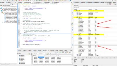

It might be an idea, because the documentation is kinda useless. I now got a flag of success and two flags of failure at the same time... Errors were cleared just before!

There are three levels at which you enable/disable interrupts
1. individual interrupt sources within a peripheral (e.g. in timer, you enable/disable them by setting bits in TIMx_DIER);
2. then all enabled interrupts of one peripheral are ORed together and output of that OR is one of the inputs to NVIC, other inputs are from other peripherals;
all these can be individually disabled (they are by default) or enabled (e.g. using NVIC_EnableIRQ() )
3. in processor, interrupts can be enabled/disabled globally (using __enable_irq()/__disable_irq()); when disabled globally, none of the peripherals enabled in NVIC causes interrupt
Here, I am not talking about disabling interrupts globally (3.). I am talking about not enabling (i.e. leaving in default disabled state) the particular FLASH interrupt at NVIC level (2), so that even if you enable interrupts at the FLASH module level (1), no interrupts from FLASH will reach processor (as they are disabled at NVIC level (2)), while other interrupts are still enabled.
