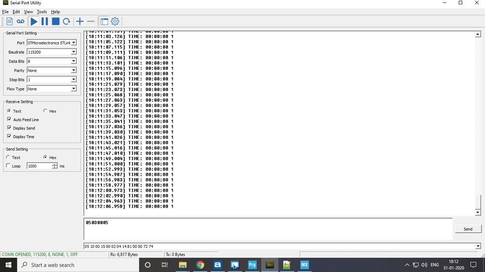

0690X00000BxBKOQA3.jpgI am using STM32F446RE Nucleo Board and want to read internal RTC timing.
But I am unable to get the time getting 00:00:00
Here I shared my core
Clock Setting: LSE : 32768Hz
System Clock: HSI : 84MHz

		  if(get_time(tTime))
		  sprintf(buffer,"TIME: %02d:%02d:%02d %d\n",tTime.Hours,tTime.Minutes,tTime.Seconds,HAL_RTC_GetState(&hrtc));
		  send_uart(buffer);
		  bufclear();

bool get_time(RTC_TimeTypeDef gTime)
	if (HAL_RTC_SetTime(&hrtc, &gTime, RTC_FORMAT_BIN) != HAL_OK)
		Error_Handler();
		return false;
	else
		HAL_RTCEx_BKUPWrite(&hrtc, RTC_BKP_DR1, 0x32F2);
		return true;

1 REPLY 1
SStor
Senior
You should use HAL_RTC_GetTime() in your function get_time().
