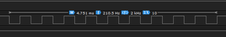

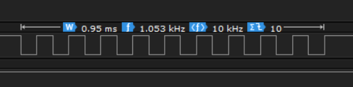

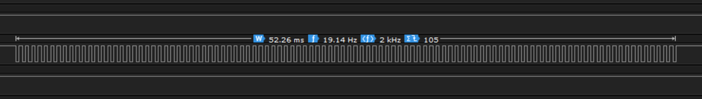

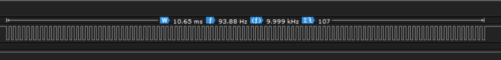

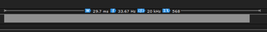

Hi All,
I am trying to generate required no of pulses using PWM. This is to implement to control stepper motor with position control.
I use HAL_TIM_PWM_Start_IT to start pulsing and count the no of pulses in HAL_TIM_PWM_PulseFinishedCallback.
I notice that the more the required pulses, the more the extra pulses will be generated. And also higher frequency will generate more extra pulses.
Attached is the initilization of the timer and call back function when the interrupt occur.

Solved! Go to Solution.
- Labels:
TIM
‎2021-04-04 8:08 AM
It works very well with your program.
Thanks a lot.
‎2021-04-04 9:13 AM
Nice! Is it a stepper motor? Then you will need to add ramp up / slow down somehow to not lose steps but also be able to reach faster speeds.
‎2021-04-04 4:13 PM
Yes, that’s what I will be doing as well. Thanks again for the help.
