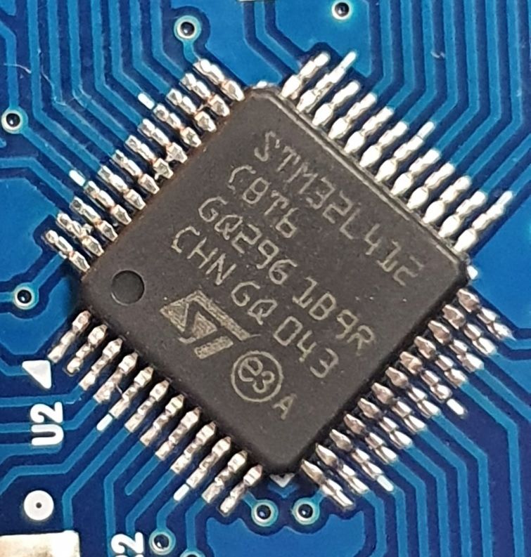

waclawek.jan
Isn't there 'P' suffix on the chip? Post photo.

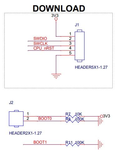

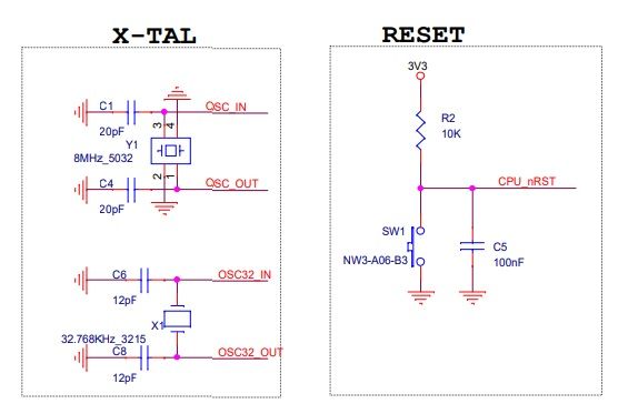

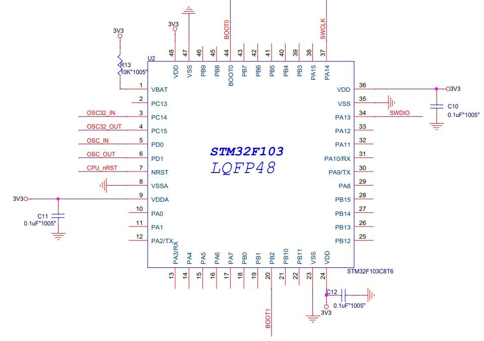

KChoi.3
thanks for advice guys
but i already do that.
software is dependent by HAL Library ( it only different ADC and TIM number)
board worked correctly when it was F103.
i tried this 3 time on each boards. ( 2 board already broken, recent one is yet. )
all they look like no problem when first. (voltage is 3.3v)
when i try programming with swd, it cant read device information. ( i checked swdio and swclk signal, it look like no response from STM32L412 )
after several swd connect try, mcu be broken. (voltage is 330mv)
this is recent one, it is not broken yet..
0693W000008yLfHQAU.jpg0693W000008yLrXQAU.jpg do i need to edit schematic for use this? (i know L412 has no BOOT1. it just low input gpio )
if i missed something, plz say that.
Ozone
Principal II
Did you check that pins like VDD, VDDA, VSS, nRST, OSC_xx are the same ?
Besides the SWD pins ?
AFAIK, it is recommended to buffer VDD with ceramic capacitors as well, electrolytic caps have a relatively low self-resonance.
"but i already do that"
But there's no way we could have known that - is there?
"i did drop in a L412CB where a F103C8 was before. ( and broke 2 L412CB already)"
Seriously?
You really should prototype this first to be sure that everything is working before just dropping a chip onto the board
